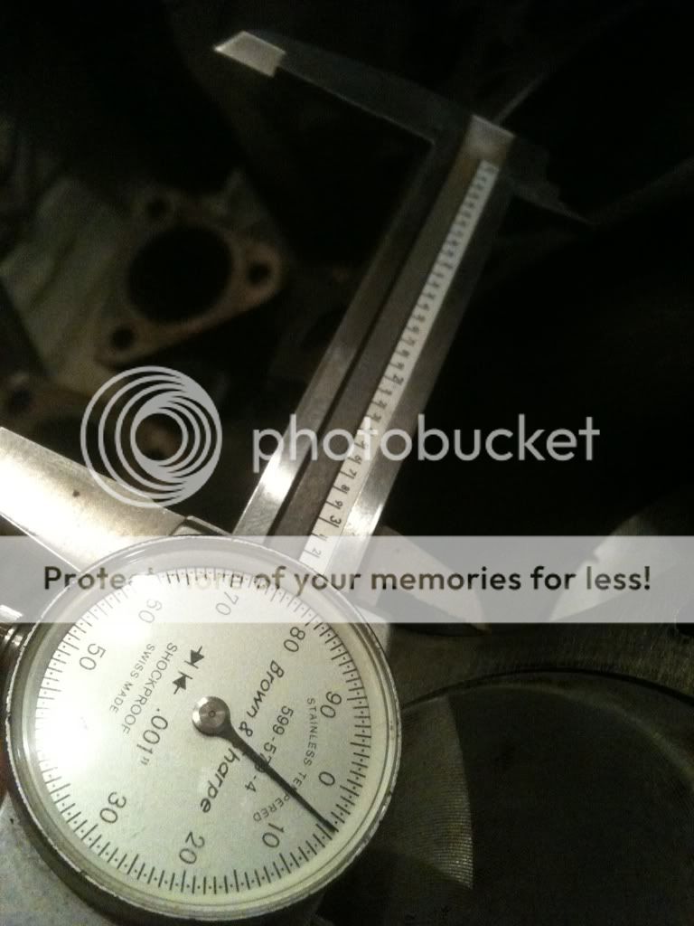

I need some questions answered by people who have HANDS ON knowledge from building motors. The motor in question is a 2.5 m20. OEM shortblock with 150-175k.
I decided to measure my engine bore on all cylinders since my head is off at the moment. Cylinder #2 and #5 have me concerned. Both were off by roughly the same amount(within .001" of each other). The top deck bore came to 3.315" which is out of spec by roughly .008". Half an inch lower, cylinder bore is still close to within spec(3.307). I have three questions...
1. How bad off is this? My compression was strong prior to pulling the head but, there was also ALOT of carbon buildup that I removed.
2. Is there a chance I will be burning off oil if left in this condition for around 2-3 years? (I will be rebuilding a short block over the next 24months)
3. Is this normal wear for 150-175,000 mile m20 or, is it possible I am getting piston slap on full stroke?
-Brandon
This picture is just to show the gauge I used. Actual measurement shown is not the engine bore.
