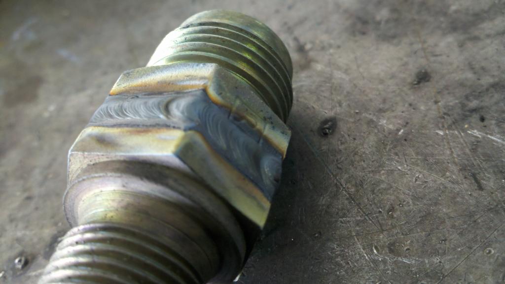

                        only photo of my welds. keep in mind its a small ass fitting..

                          damn, doesn't you hand get hot holding the torch like that?
