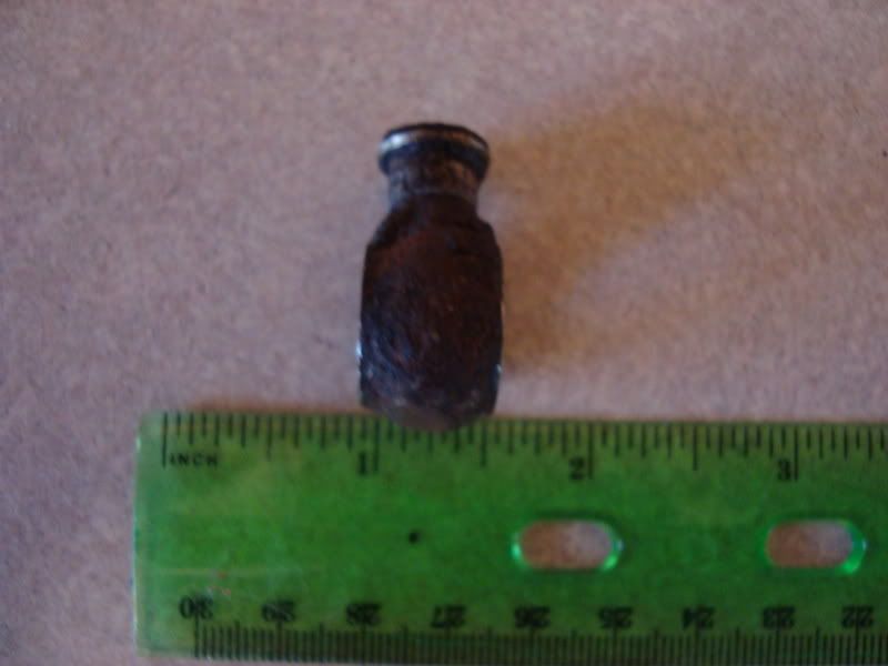

    where can i buy one of these????
    1984 318i Auto tranny was leaking from the oil cooler hose and when attempting to fix, this broke. not sure of the proper name. anyways i need one very fast and have no idea where to go.
    cheers and ty for help.

    Go to realoem.com, look up the model and year build date of your car then shoot Blunt @ Blunttech a PM with the part number.

      That's a banjo fitting.

        not listed?
        the build date of my 318i is 11/83 and i looked on realoem, not there. i looked under radiator as that is where the lines are and it is a totally different setup. can someone take a look and see if i am missing something?

          Check in junk yards maybe?
          • Click
            • 637
            Could take it to a local welder and have him clean it up and weld it. Wouldn't be expensive.

              Looks like a banjo fitting. Go to Napa

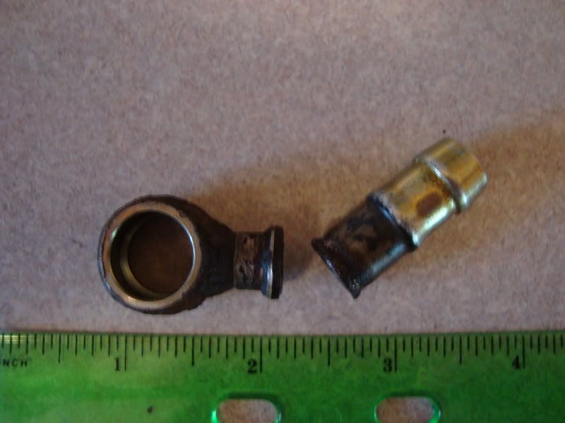

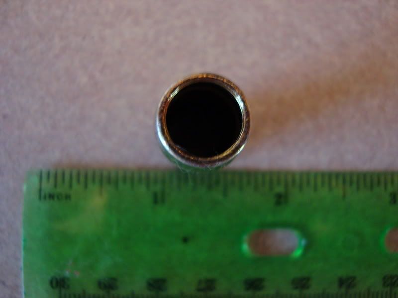

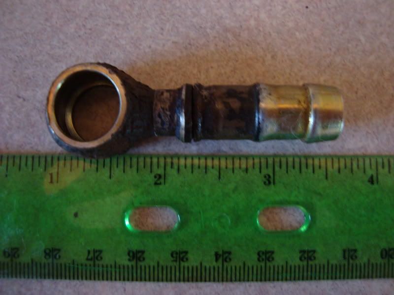

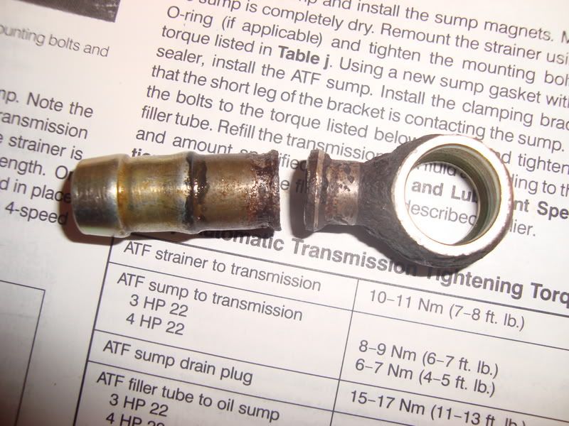

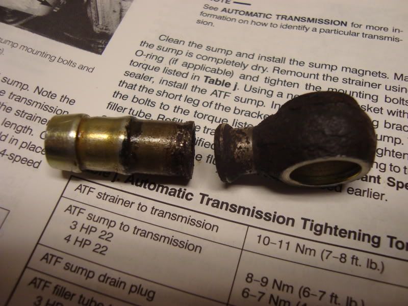

                  OK I have tried everywhere to find the return line, bmw says it is no longer listed. I have an 84 318i, build date 11/83, VIN WBAAK8405E86880008. I have tried desperately to find the Auto transmission cooling line (return) and it is nowhere to be found. I need the car on the road ASAP, I need your help. If anyone finds it i am also interested in the supply line. The broken banjo end cant be repaired as it is riddled with pinholes of rot. I am desperate, will buy used, new, whatever. If you know of anyone parting the same car please contact me.
                  Here are some more pictures for size reference on the broken end.
                  • Holland
                    • Nov 2008
                    • 7212
                    I couldn't find anything on this, either BMW updated the lines or your line was changed from OE at some point. The only solution I can see is to get new, updated lines: http://www.pelicanparts.com/cgi-bin/...FILTER_TOOL=ON
                    Or just find anywhere that carries banjo fittings and see if they can come up with a close match.

                      http://parts.bmwofsouthatlanta.com/s...mission%20line
                      part number 2 i think

                          Originally posted by CW325
                          I think we found the winner.

                            Its a simple hydralic line go to an industrial suply store
