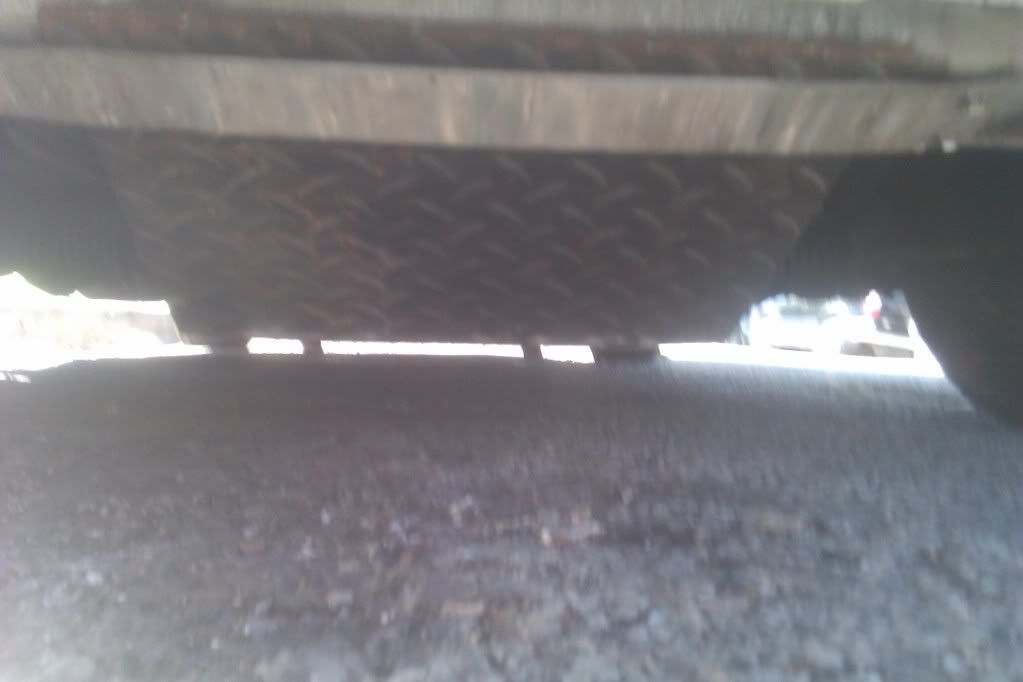

    Had a skid plate made yesterday out of 1/4 inch hardened diamond plate. Was debating if i should just paint it black or a grabber green. Needs to be painted to avoid rust.
    Said skid plate

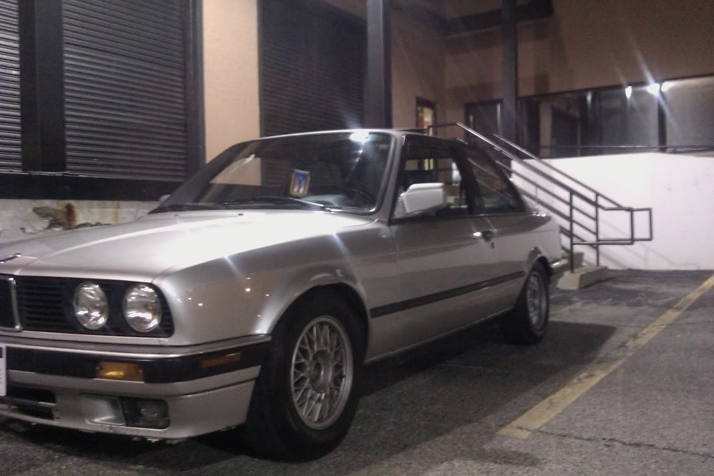

    Said e30

          How strong is that plate? And are you going to add any slots for air to pass through?

            Plate is stoupid strong. Its the same plate used for the loading docks ramps. Not really planning to add air slots.just glad to be able to protect the pan. Chicago streets aren't a joke.

                            I would like to see how its held on... I need to make mine today and wanted a little guidance.. I think it should be clear coated and left alone.. but its just my 0.02

                              Two grade 8 nuts and spacers welded to the subframe and holes drilled through the plate near the back. Pretty solid. The front is just a plate across to keep it pushed up so it has some flex
