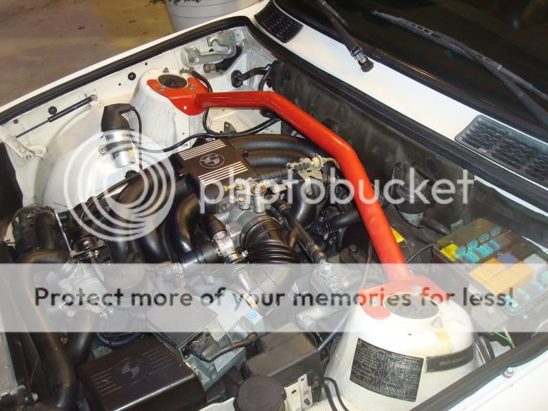

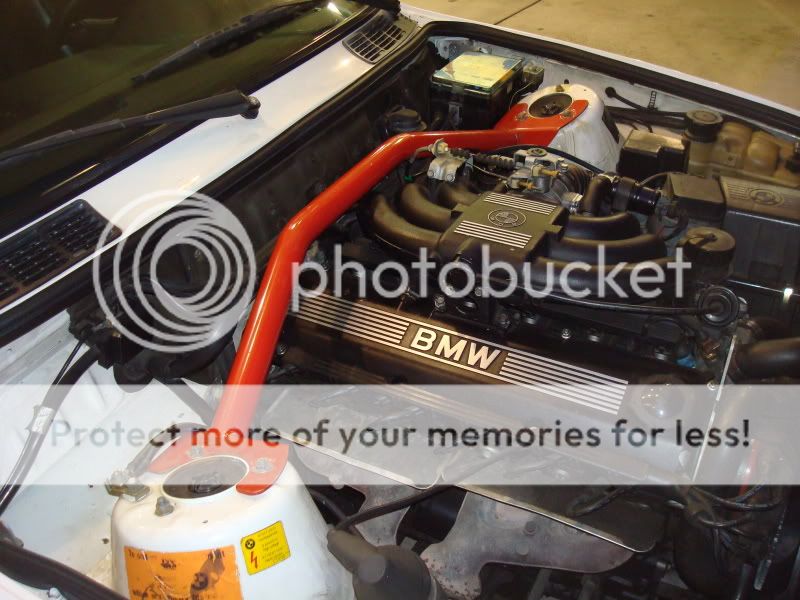

    Hello guys,
    I recently acquired a Sparco strut bar, went to install it and it does not clear the cruise control line,
    What have some of you done to maintain cruise control,
    i browsed the engine bay picture thread but no luck
    it broke the plastic clip
    stock
    passenger side
    driver side

            In mine i hammered the base with the lines a bit down and it worked and cleared the bar. I dont have cruise control though, but it indeed hit the throttle cable.

              I bent that piece down when I was running an M20 with Sparco bar...had no issues

                  All i did was bend the bracket down and my CC still works.

                        Fuck!, just get the cruise control bracket from an early model and swap'em.

                          i tried that the bend in the hard line in the cruise control wont work.

                          do have any other angles?

                            Yeah bend is what i meant when i said hammerded down. Just bend the whole bracket from the right side. if you stand by the driver side of the engine look at the bracket and bend it from its right side closer to you. If it doesnt work with pliers use a hammer and carefuly hammer it down.

                              thanks for the tip whats the difference?
                              its just a accessory i would like to maintain.
                              It's shorter and won't block anything.
