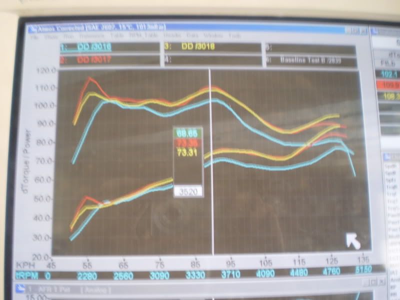

    i miss my eta.. Wasn't fast but wasn't slow. Id stay with the 325i guys in the mountains with ease (better power band for 2nd and 3rd going up hill) Very fun! My vert is much faster than my eta was but i miss that super low end tq. My eta put down 88WHP at 4900rpms and 118 foot lbs of tq at 2200 rpms, wasn't chipped and had plenty of intake leaks. Could easily pop the rear end out when needed.
    • e30trooper
      • 11576
      325i w/ 3.73
      325e with 2.93

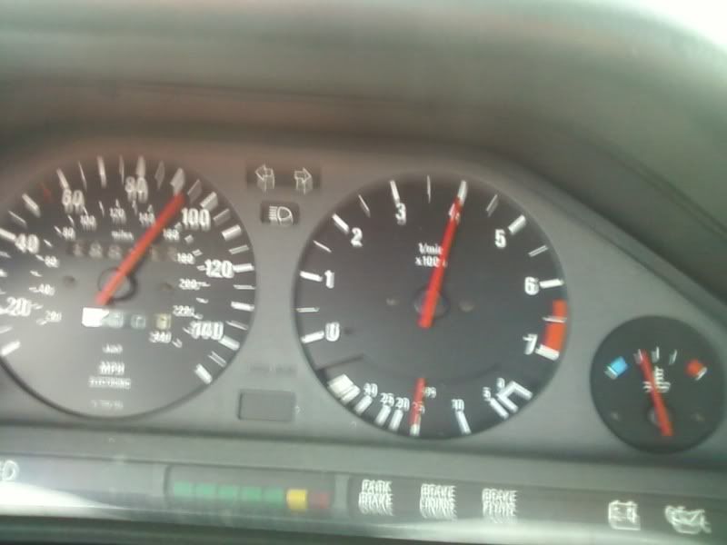

      ^^ super eta cluster with eta coding chip if your wondering why it has a 5500 rpm redline.
      dyno

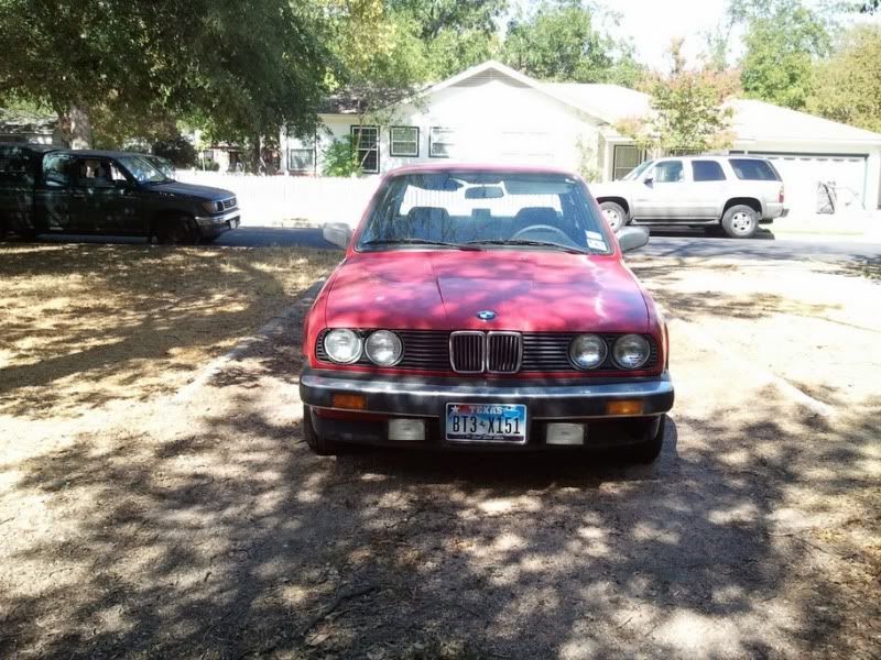

                      Oh here is Charlie's glamor shot - it has been driven by my friend since 1994:
