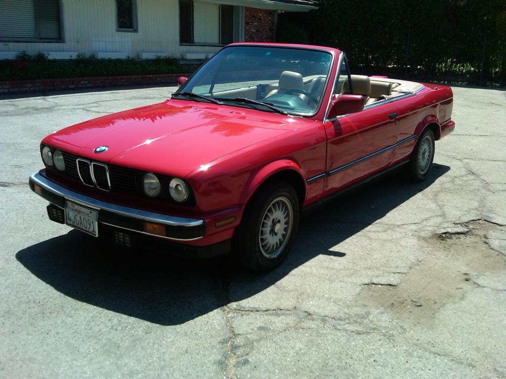

    19 here currently going to college, recently just picked up my first e30 (also have a e90 330i, but always wanted an e30). 1988 325i Vert, Zinno on tan w/ approximately 200k (broken odo). Just have a couple questions.

    Here's a pic right after I got it detailed a day after picking her up.

            did i just see this car at castro's?
                yessir thats mine, i'm currently in the process of applying to transfer and taking 14 units so the major work i just decided to get out of the way at castros
