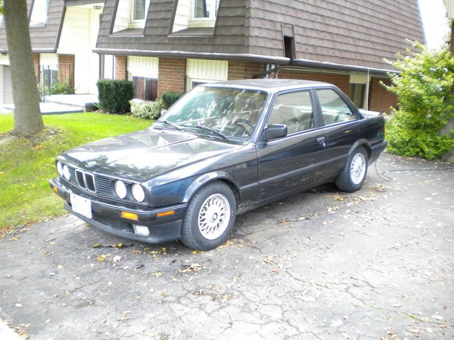

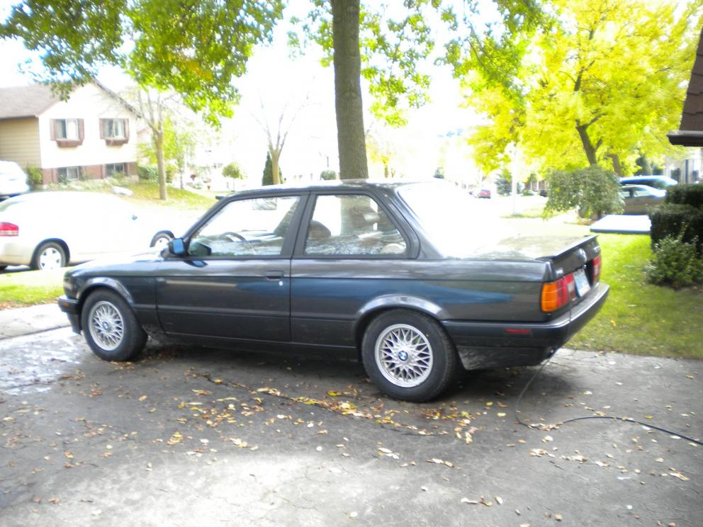

                  Here`s my dedicated winter beater of 6 years, while my Touring is in storage. It only gets driven in rain, snow and generally sh1tty conditions, has about 95% original paint (a few small rocker areas were touched up) The black paint hides a few dabs of grease over a couple of small rust spots that haven`t become any worse in 6 years. I should also mention that my 318is has NEVER seen the inside of a garage or a car cover for that matter- it has literally spent it`s entire life outside.

                    Was that car on Kijiji? I saw a 318is just like it on there a couple months ago and was going to go look at it, but the guy was asking way more than I wanted to spend on a beater. FWIW, if it IS the same car, that's not the original paint, so it may look mint but who knows what's going on underneath...
