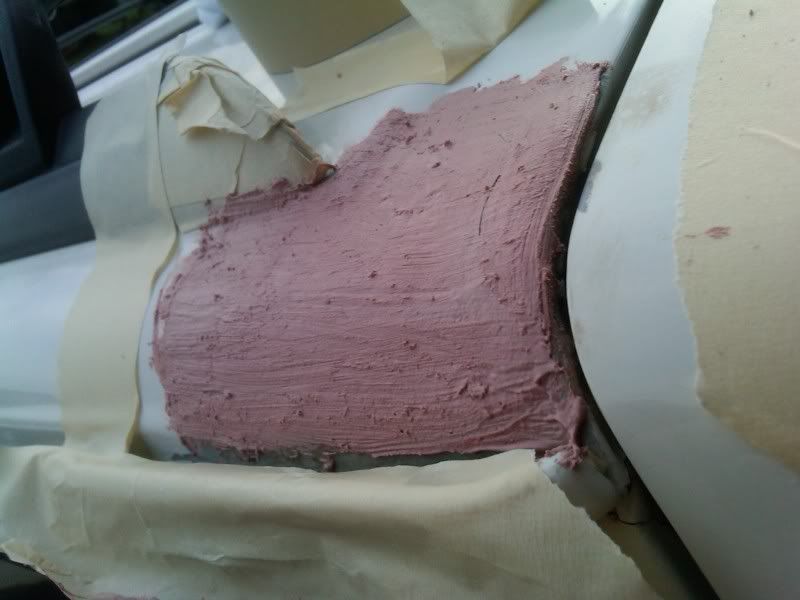

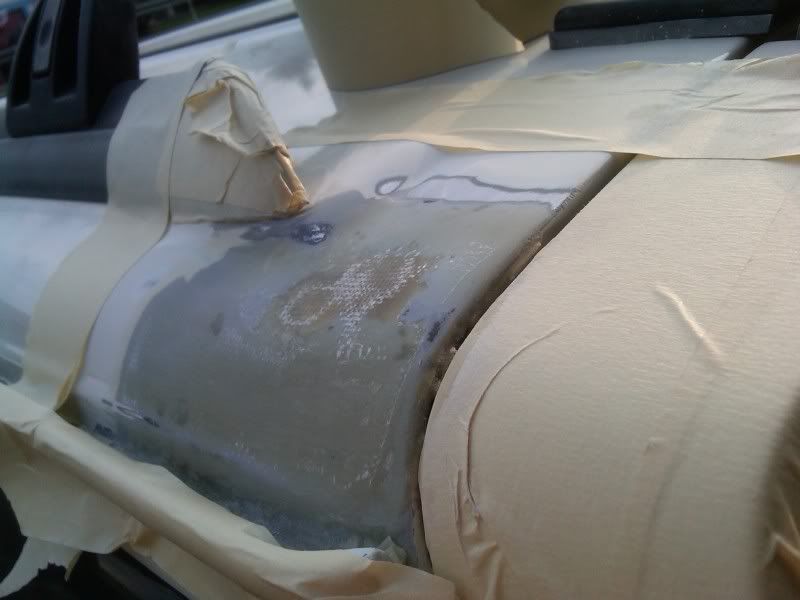

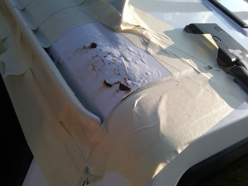

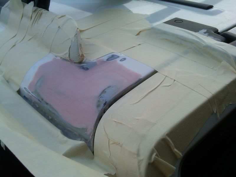

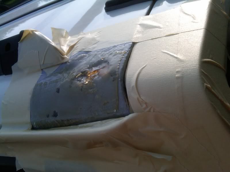

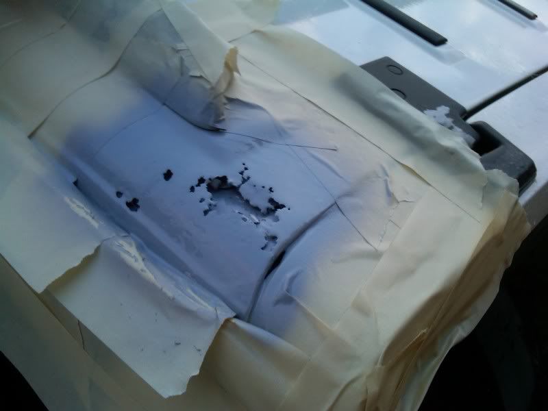

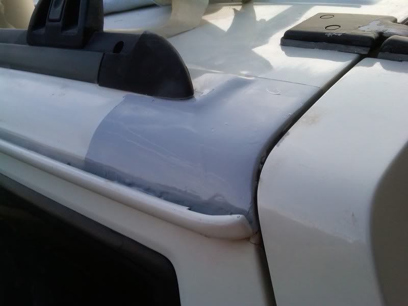

                How I've taken care of small rust spots on previous cars is wire wheel down to bare metal. If the rust is already rotted through there's only so much you can do but I've had decent success in the past using a rust disolver you can buy at any auto parts store. After a few coats of that, should turn blackish/blue, hit it with some etching primer. Then I've used epoxy or fiberglass resin to fill in any imperfections left, sand smooth and paint.
                This was in the roof of my old Cherokee.
                This is after wire wheeling and a few coats of disolver.
                Primed
                Small sheet of fiberglass mat and resin
                Second layer of resin and some sanding
                Bit of filler
                Sanded (another layer of filler and sanding but you get the point)
                Done. Well, a bit more finish sanding was needed but whatever.
                Can't find pictures of it painted but I did this 2 years ago, sold the Cherokee to a friend and there isn't a trace of rust in that corner still. I'm not saying this is the best or easiest way to "fix" rust but it's worked well for me in the past.
