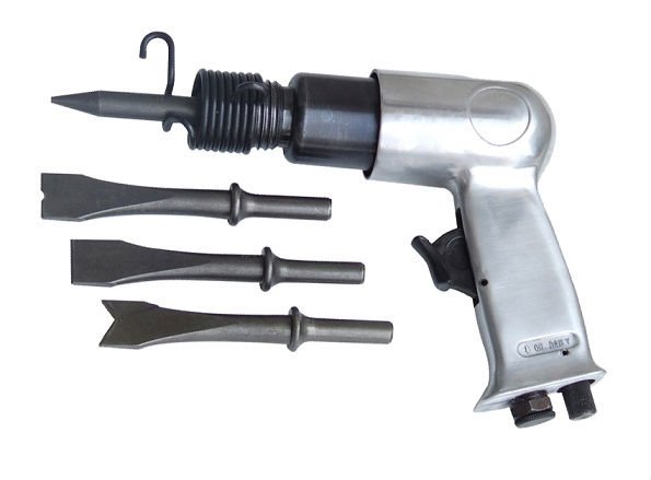

        Originally posted by leolee875
        ideas on getting the broken extractors out
        this and that
        Last edited by cabriodster87; 11-21-2011, 08:39 PM. Reason: and pressurized water extinguisher.

          this and that
          would the air hammer fuck the bolt hole ? up like widen it more or something ?

            For such a problem, I usually use a mig welder to add metal to the bolt until it is above the level of the surrounding frame, then I weld a bolt to the extended metal. The heat of building the weld extension usually frees the bolt, and then it twists out easily enough when I have a bolt head attached to it. It's not hard, but it helps to have a little welding experience.
