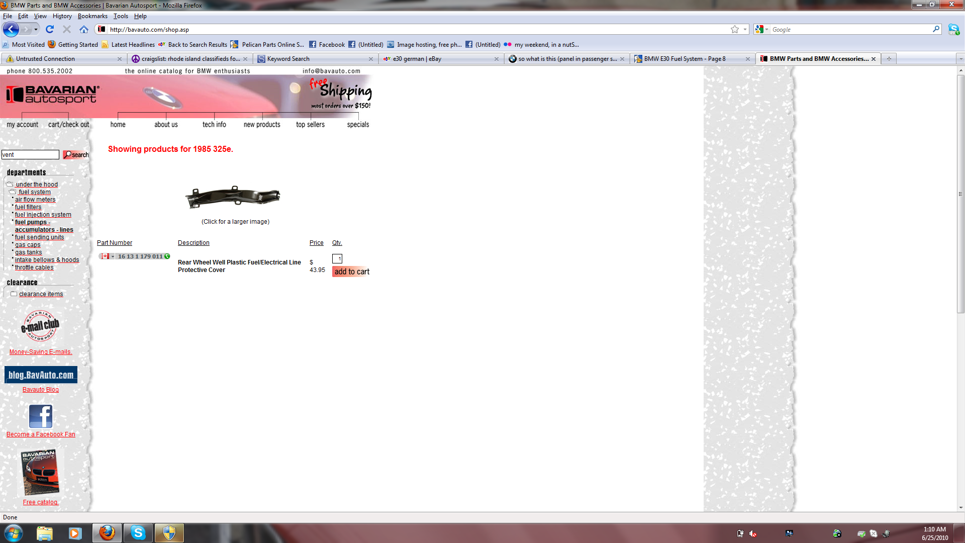

              Access to fuel lines that run on top of the tank?
              • TimKninja
                • 2131
                I herd it was for the fuel vent line.
                theres nothing left of mine ethier.
                You can get them new tho.
                Here Found it. Bavauto wont let me link

                  it is to the "over flow" and air lines that sit behind the plastic
                  • ZM Blue Devil
                    • Dec 2006
                    • 13836
                    yeah 8 of 10 e30 that come in have that piece rotted... We just stock new ones, relatively cheap. Just make sure you order the correct one as there are two versions.
                          yep
                          thanks, I finally pulled the wheel well liner and it looks like an evap system/overflow tank as you said. Random place to put it, and the main hose looks gnarly. Wonder if it should be replaced :/
                          thanks, will do.
