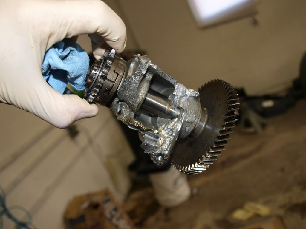

    06 GLI that I spent way too much money on installing a GT3071r, BRUTE forged/rifle drilled drop in rods with stock pistons, snow perf w/m, and many other modifications.
    The goal was 500whp, I had it to 400+, enough to pull on a 470whp GTO.
    This motor is direct injection, so it wasn't obvious that my in tank pump was failing and causing a lean condition until this happened....

                    Mmm that lean condition looks nasty. Was it only leaning out in one cylinder? If not did you have an A/F gauge hooked up that would have, diagnosed the issue strait away.
                    Anyways I always thought VW's are gay so welcome, and you can collect your man card.
                      Yea I didn't do enough datalogging. The stock ECM on the car was very advanced and utilized a wide-band from the factory. I put a little too much trust into it to pull enough boost and timing to keep it alive.
