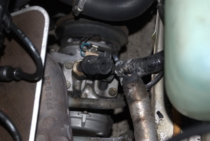

    oil in your coolant 0.o
    and what are the first two?
    your ac condenser caught fire???

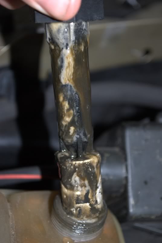

        Coolant light was on when I started it today. Wasn't before(like when I was driving it yesterday)
        AC lines burnt to a crisp, all the way through. Something got hot.
        Gunk/oil on the coolant sensor. Resevior cap broke leaving the part that goes into the tank stuck in it.
        No coolant in oil though.

              that definitely blows, sorry to hear man!
