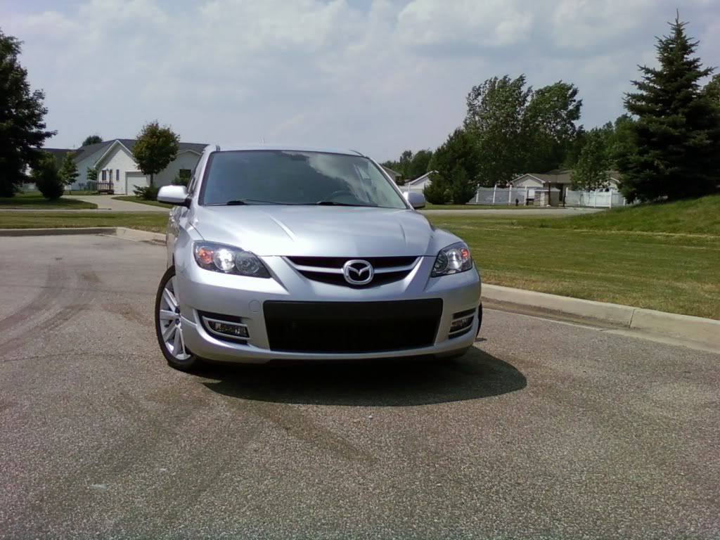

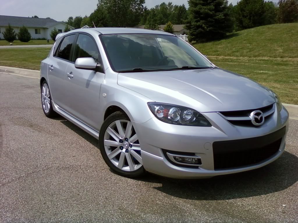

            True, Mazda admits this now and a dealer fix is warranted on 1st gens. I currently have 57,000 miles and running strong with no smoke or leaks. The 2nd gen are nice because of the updates and you could find one with very low miles. I opted for the first gen because of the less flashy styling, GT package, much better bolstered seats and interior. 2nd gens interior is really busy with red splattered interior. And not to mention the clown face.
            GT package:
            -adjustable HID headlights
            -Bose stereo
            -leather trim
            -Navi
            -LED tails
            -rain sensing wipers
            2nd gen......(clown face)
            splattered interior, no bolster support....
            1st gen........
            Better seats and interior 1st gen....
