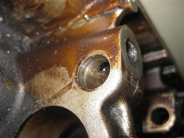

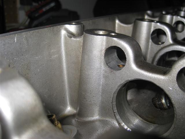

      So this is mainly based off talking to folks on the phone who build m30's and not some josh brown knows all about these engines. I don't think this applies to m20's. The shoulder on the M30 oem head bolt protrudes into the rocker shaft bore. By shoulder, see my snazzy arrow here
      Just to make sure I went into the garage. 1st pic is a m20, see how there is no intrustion from the head bolt into the rocker shaft hole. 2nd is a dirty m30, see how the two bores (head bolt and rocker shaft) intersect? That's where the shoulder presumably exerts some side load or at least locating point for the shaft. This is my understanding, not fact, and has little to do with conversation this thread was originally meant to discuss.

        Originally posted by browntown
        So this is mainly based off talking to folks on the phone who build m30's and not some josh brown knows all about these engines. I don't think this applies to m20's. The shoulder on the oem head bolt protrudes into the rocker shaft bore. By shoulder, see my snazzy arrow here
        Wow, I never knew that about the M30 cylinder heads.

          Shoulder keeps the shaft from moving as the M30 has four shafts, not two like the M20. M20 looks like it is held together by the half moons on the front/back of the head. (IMO)
                                Does the nut that fastens to the bolt have the shoulder?
