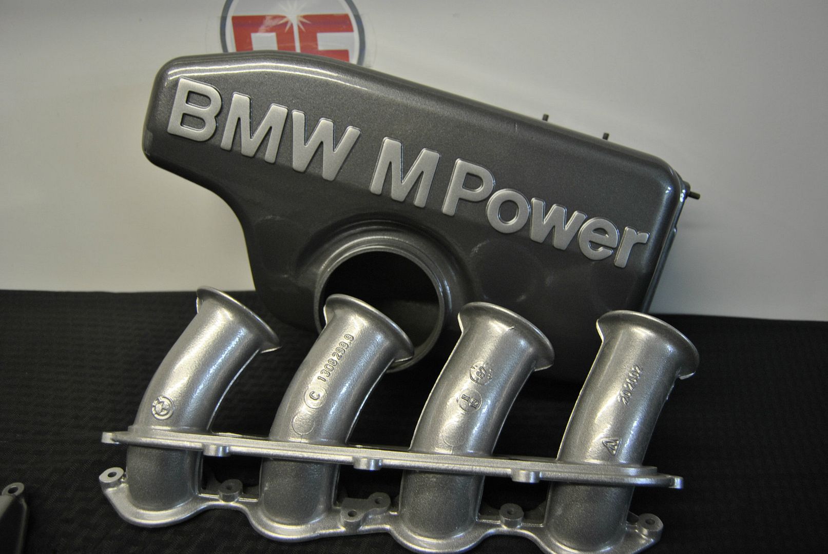

    Primarily for metal parts only. Because it all has to be cured in an oven, some parts can not stand up to the heat. Some plastics, glass and wood can be coated with the proper technique. But not all....
    All the BMW intake manifolds and valve covers that are called plastic are actually made out of glass filled nylon. They can be coated because the melting point of them is high, but the technique is a royal PITA and is not worth the hassle. I have done a few of the M50 intakes and S52 covers but they are a pure nightmare to get right and not worth messing with.

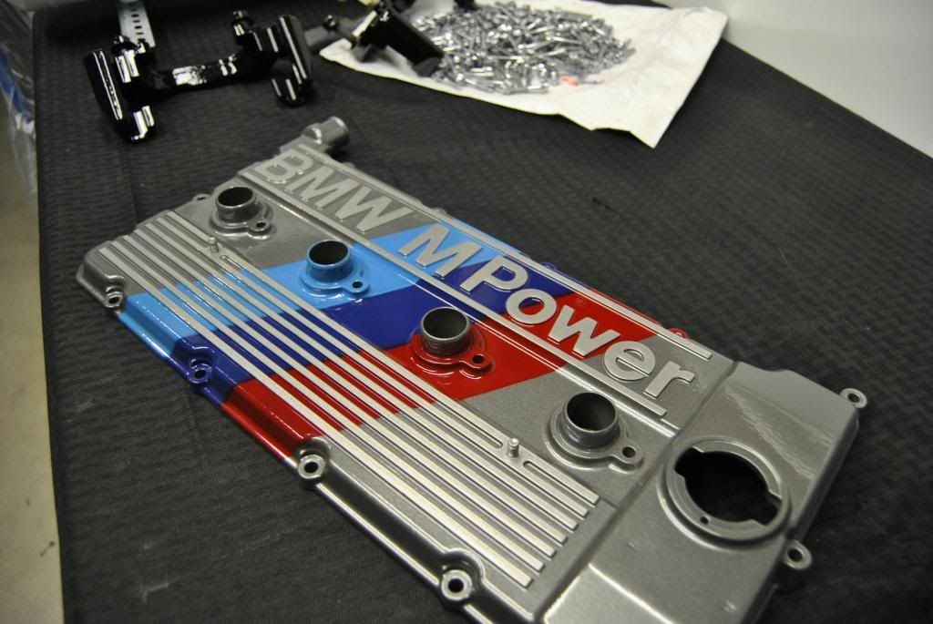

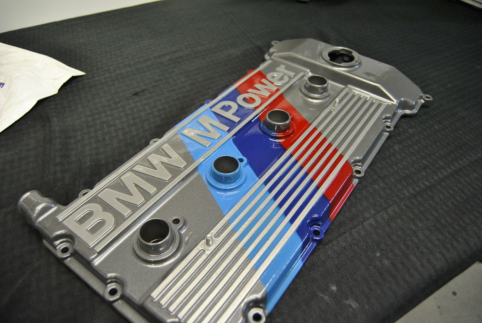

                  For my buddy Igor at CAtuned-Auto Heaven
                          Whats the deal with the hardware on the right? BBS ? Do you refinish them?
