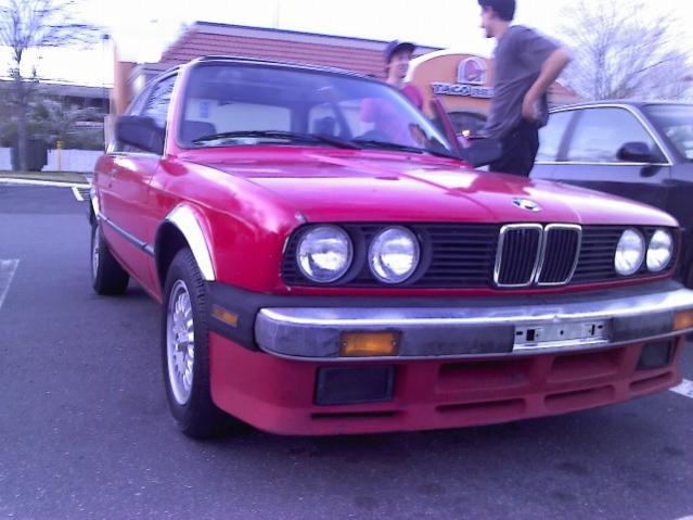

    So a few days ago i purchased my first e30. a zinnobrot red 1986 325e. i got her for a 1000 bucks off a very nice gentleman (with a gun) in running driving condition. has a few minor rust spots here and there but other wise the car is in nice condition. we drove it about a hour and a half home with out it blowing up so that is also good.it came with new tires new muffler new timing belt new tune up and a (very ghetto) cool air intake. the only things that arent so good is the blinkers dont work, the power windows dont role down, and there is a very slow oil leak somewhere. the guy i bought it off of said the windows and the blinkers is just a fuse but im not completely sure so any ideas would help.

                      p.s. what lip is this?

                        I think it's just the early model "E" valances I wouldn't take my word for it though, just a guess. I more only know about 87+ euro/US valences/lips...

                            Looks like an IS lip to me, I believe the ES lip doesn't have the two inside bottom holes which provide air to the oil cooler. Pics of engine?
