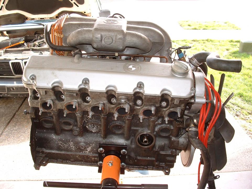

    I've got a 1985 323is euro car, it has an m20b23 motor. dropped a valve and blew a hole in a piston at the track last weekend.

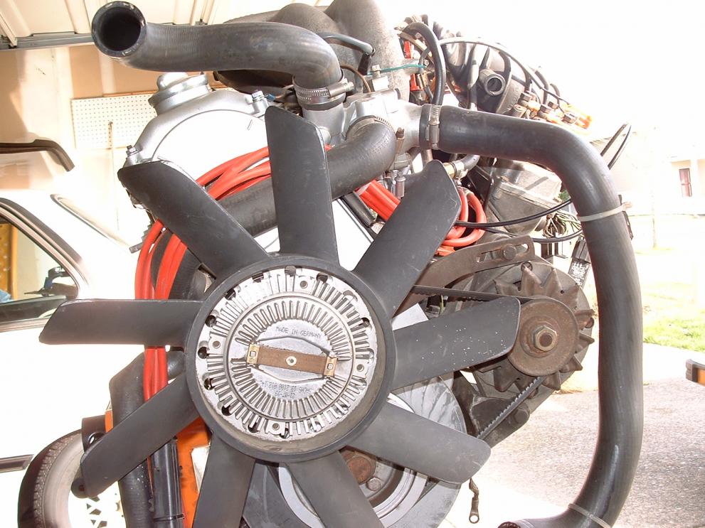

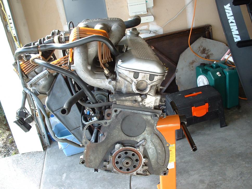

    I've found a guy with a m20b23 motor out of an e21. He sent me pictures, see attached below.
    Far as I can tell, the intake manifold and fuel injection system are the key differences.
    Question:
    Can I strip his motor down to just a core and re-assemble with the intake and fuel bits from my engine?

    Does yours have a distributor?
      Yep, looks exactly like his.

        Then it seems like you could just swap longblocks.

            just use a B25 (325i motor) M20- you can pull out the plug for the distributor. and everything else is doable (need to change the cam gear too I believe). more hp/displacement and looks the same.
            yes, the e21 block will work too.

                I agree, but if i was going to go through that much work, i'd just go all the way and twin-cam the car. But in this particular situation, just looking for a drop-in replacement.

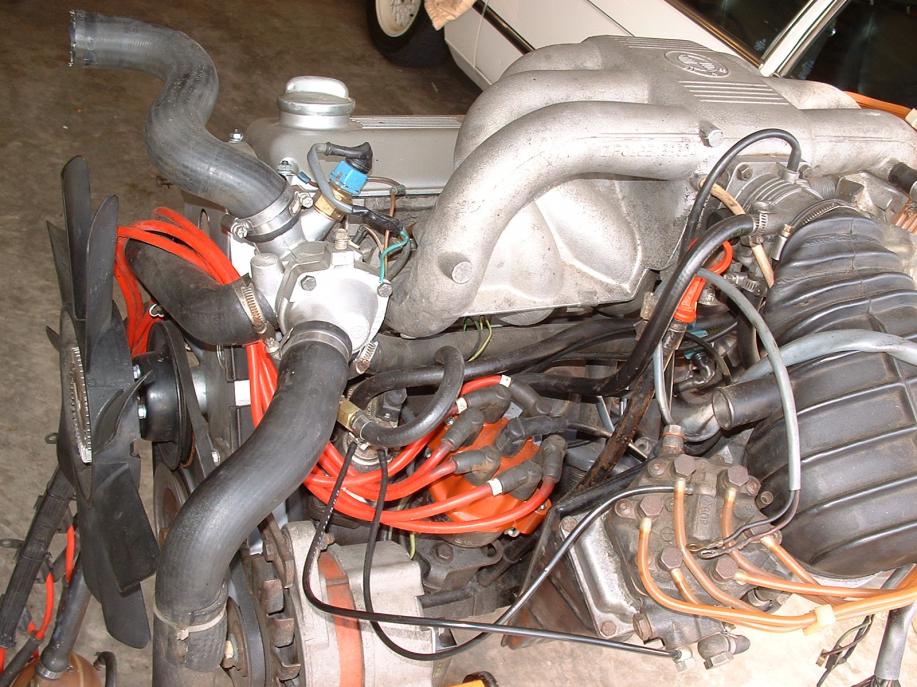

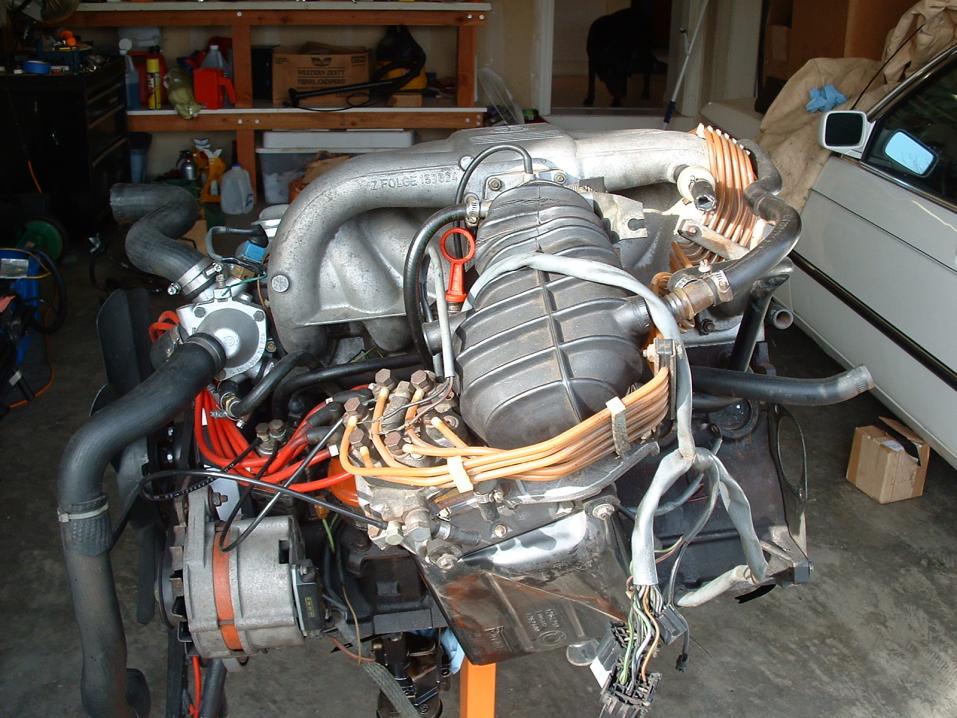

                My intake manifold
                Dude's long block
