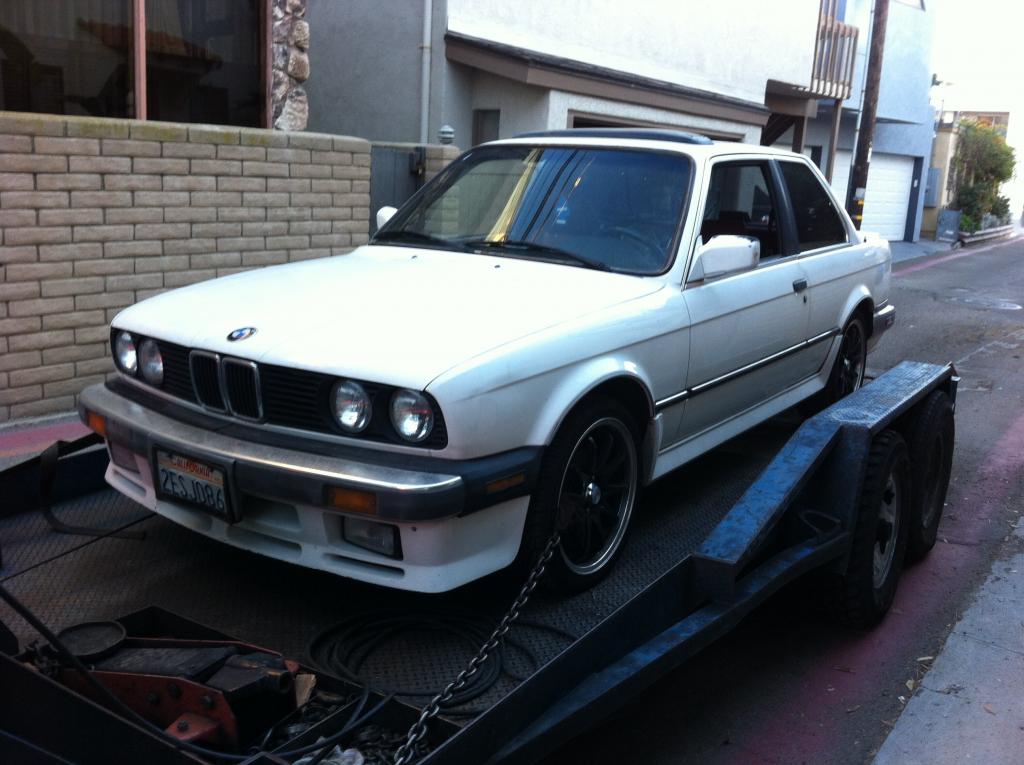

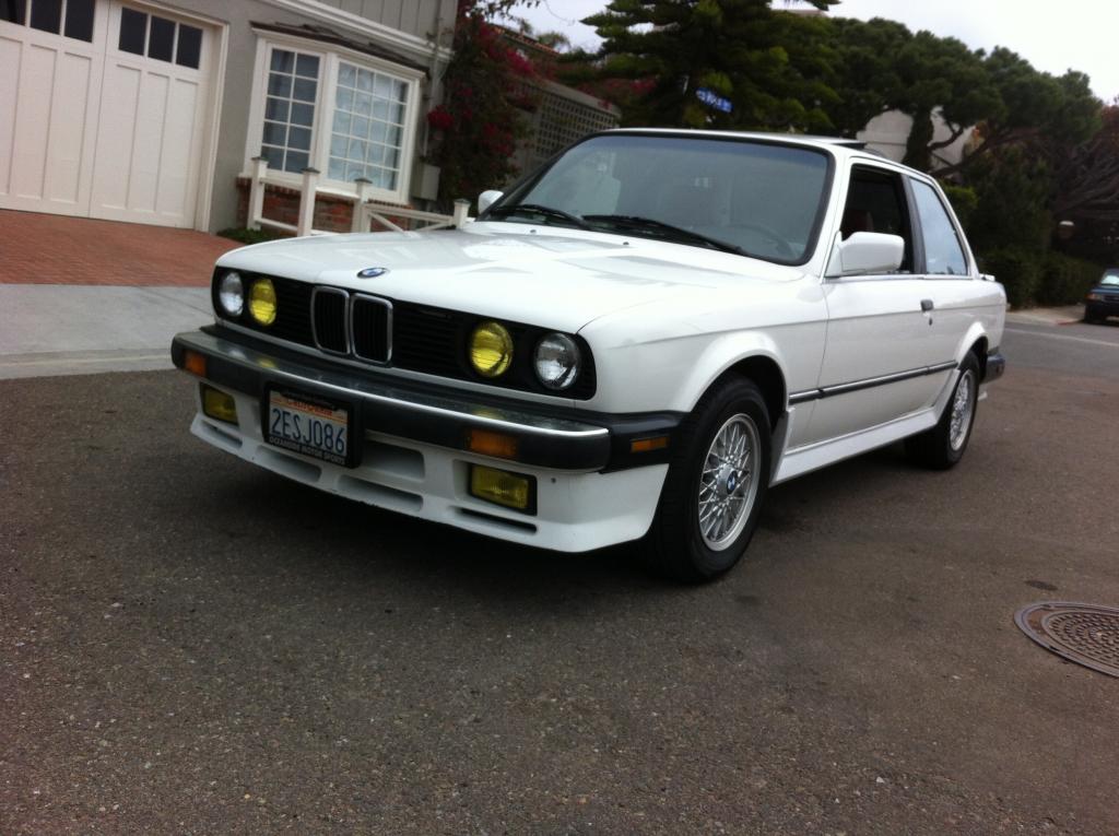

    And now for car #2!
    Very Clean 1987 BMW 325IS series with manual 5-speed transmission. Been in family for over 11 years. Solid White, Straight Body, Interior Excellent, New Stereo/CD player. Regular oil changes, new starter, new struts, new plugs and wires, modified exhaust, A/C needs freon, possible drive shaft joint replacement. Driven on a daily basis until Christmas last year when driver purchased a different car, been non-oped since then but with regular start-ups. This car is fun and you will get lots of admirers. :)
    So my issues with car #2 are:
    1) No pictures of interior
    2) Talked to the guy and he said odometer is frozen at 210,000 or so which is a little high
    3) No 325is badge on the back
    4) 1987 is a bit older than id like honestly like
    5) almost twice as much as car #1, the seller wants 3500
    6) I don't know how difficult it would be to replace a drive shaft joint
    So there's my dilemma, please help a first time E30 buyer find a new baby! Any opinions, tips, advice, or questions are more than welcome!

        Car #1 is Bronzit and in your climate certain colors (bronzit, calypso, diamond schwartz) will have clear coat peeling if not garaged for a lot of their lives. This car has an airbag steering wheel and that can be a plus to some people but others will argue that how safe is a 21 year old air bag? This car looks like it has its maintenance kept up and has some new parts.
        Car#2 paint has almost 0% gloss- this might polish up or might not. It hasn't been on the road for over nine months and if it has to be repaired by some one other than you will cost at least $500 to fix. It is an iS so it's has more options that car #1 doesn't have but it is pre- facelift with diving board bumpers. There isn't really much data on maintenance other than oil changes and one key item is when was the timing belt changed on both cars? Also coolant flushes and brake fluid flushes? All these can lead to costly repairs if not performed in the last two. three years.
        I would say Car #1 is such a good deal its probaly already sold..... Good Luck and welcome to the fold!

            But ride #2 is more pimped: white car, basketweaves, 2-door. Don't count on that price to stay put: you will realistically want/need to put money into the car right away: drive shaft joint and maybe shaft support bearing; maybe it's not that - maybe it's wheel bearings, or a loud differential. AC not working. Interior (?) You may very well have these with car 1 as well, but I am going to bet someone who bought a bronze 4 door took more "standard" garage care of the car than the owner of #2. Now how's that for a stereotype! :-)

                  Between those two cars the 87iS is the easy choice. Values of well-kept and/or reconditioned E30s are only going up, and 87s have the unique front valance which makes it a little less common than cars with plastic bumpers (which are very common). Put a little time and money into that '87 and it will easily be worth more than the asking price.

                        I had an 87is in alpine. It was and is a beautiful car and the metal bumpers with that aggressive valence really do look special. Sport seats are a plus as is equipment levels and LSD. A full day of hand polishing and sealing the paint can really bring back alpinewiess 1 (a single stage with no clearcoat) to 98% perfect. As shown in my before and after pictures. The car without an enthusiast owner will likely have similar issues not disclosed as stated above for car #1. Since it has been sitting you will need to drain the tank and replace the fuel filter, timing belt and the tires are likely out of round, the battery will absolutely need replacing.
                        The fact that this one is twice as much makes this decision a toss up, honestly if you get bitten by the e30 bug your spending will quickly eclipse the purchase price of the car, often several times over so buy the absolute best platform you can or you will just be polishing a turd.
