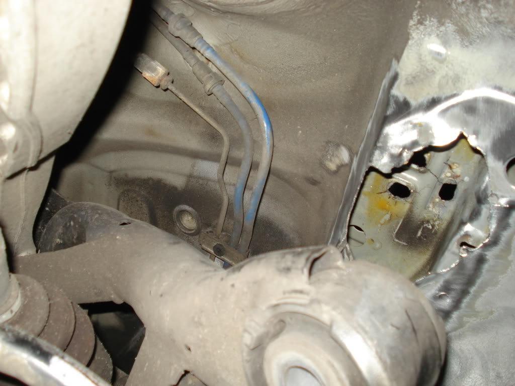

    Here's the deal with the subframe stuff: chances are it has happened or will happen to most manual E46s. What happens is the torque of the motor going through the diff will pull "down" on the driver's side rear subframe mount and after so many thousands of torque cycles (which is amplified with a manual trans) it will fatigue the carrier sheet metal and develop cracks. A pretty huge oversight on BMW's part. Facelifted models (03+) are more resistant since they were strengthened a bit, but it didn't work much better.
    In order to fix it, you need to drop the subframe, drop the tank (since you will be welding), weld up the cracks that have already formed and weld in reinforcements. I personally think it should be done whether or not the car has symptoms since it is fairly likely to develop them eventually.
    Reinforcement kit is $150ish. I've found a few shops around here that will do it for $900-1200, but if you are or know an experienced welder then you can do it yourself. Some have had luck getting reimbursed by BMW, but lately I think the best you can do is have them cover 20% of the cost under "good will" if you are lucky.
