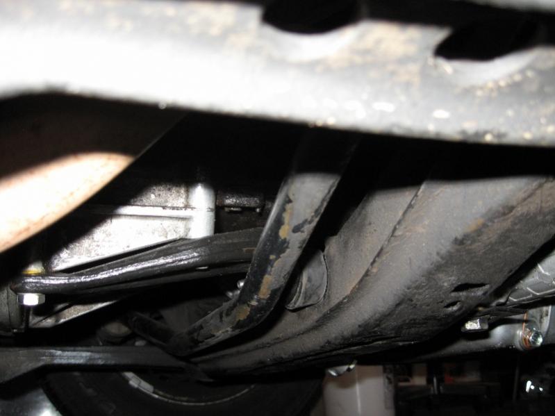

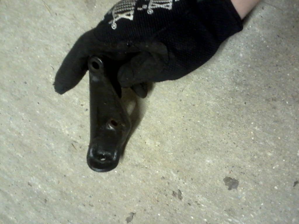

    What is this part? came from a 1988 325is Manual Transmission swap part out. I got it in the box and cant seem to find where it goes. I looked on RealOEM but didnt see it. What is it and where does it go?? I asked the seller but he wasn't sure either but he knows it was part of the assembly.
    I remember taking it out off the bottom of the engine. I thing it braces it against the subframe. Realoem that area.
    Edit: found. #14

      Cannot tell from the angle of the picture if it is bent or not. But it looks like the brace that bolts to the bottom of the transmission on the back. It holds the exhaust up. Better pictures can help resolve it.

        if i remember correctly its a bracket so the motor doesnt slide forward
          Thanks a lot everyone! i was searching the wrong area. I appreciate the help
            I really cannot tell from the picture, try a front shot of it or something. Looks like you are standing it up?

              Granted, the picture is completely terrible but i found out what it was, now i need to find a seller for the stopper, but that's for the future
                what was it?
                  ding ding ding! winner winner chicken dinner!
                  Gigitty Gigitty!!!!
                    Some say it's to prevent the motor from moving forward in the event of a collision but I have heard of torn motor mounts from heavy braking. One racer commented that he had replace the rubber stopper after almost every race.
                    I replaced mine with a rubber cork I picked at Lowes. Just drilled a hole through the cork with a little countersink so the bolt head is below the rubber.
                      That seems like a good cheap idea instead of hunting down this stopper. Do you remember what size stopper for got?

                            They had a variety of sizes. I grabbed one that matched the diameter of the bracket.
