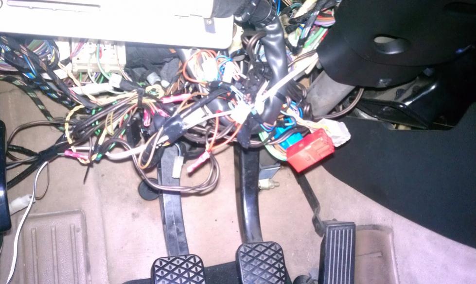

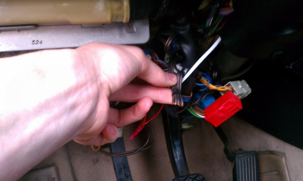

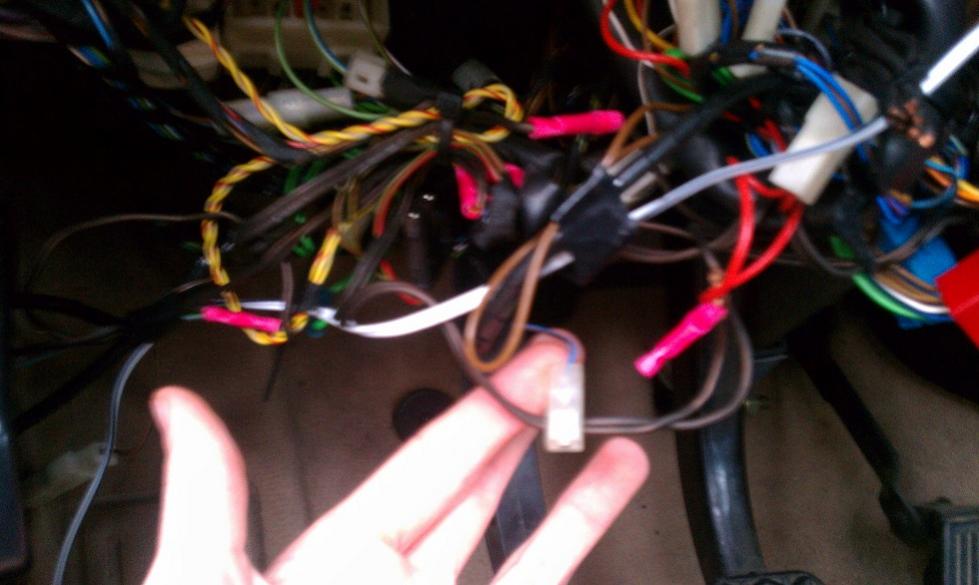

                    just a quick look at what im working with
                    red blue and white square things
                    Brown wires that look cut

                      I had a bunch of wires under my dash that were cut, sliced, etc. Most of them were aftermarket cruise control which the previous owner removed. I just traced them back and removed them. Those brown wires dont look stock, but Im not sure.

                        yea its a terrible mess and i know nothing about wires/electrics on a car so itll probly end up staying like that for some time..ive tried to find spots for the stuff but no luck..any clue on what the red blue and white square things are?
                          Im a noobie when it comes to electronics too.
                          I have issues with my gauge cluster too. Bouncing temp gauge and the right side lights are out, including the light on the clock. So far I replaced all the bulbs on the cluster and tightened the ground screw on the back of the gauge cluster. Didnt help much.
                          My next plan is to check the SI board for corrosion and replace if needed.
                          Its annoying because its really the only electrical issue i havent fixed yet.
                          Not sure what those plugs are. I think theres a wiring diagram on here somewhere. At least you track down the wires by color. Those plugs look stock, but I will snap a pic of mine when i get home.
