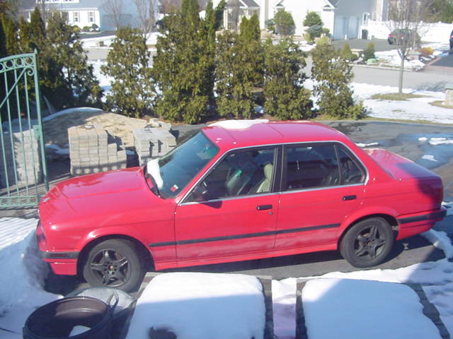

thanks but might add up being to much to that then auto paint and auto clear just to paint my skirts and lower valance
still no luck and getting tired of going back and 4th.
ive tried 4 different reds so far and its all on the orange tint of red. i find it hard that duplicolor or rustoluem color match dont have red bimmer paint

this pic is with the cheap walmart red paint
also duplicolor frame red was brighter then rusto regal redLast edited by grays; 03-10-2013, 11:18 AM.Comment

I highly recommend paintscratch.com. I used their zinno to do the bumpers and mirrors on my car, and they turned out like this. No, it's not normal rattle can cheap, but it's a lot better.
