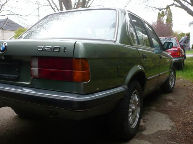

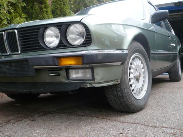

    320i E30
    Soo about 5 years ago i bought what i thought was a 84 grey market euro 323i.. Got it for a steal and noticed it was registered as a 320i and didnt think much of it at the time, then parked it to build some drift cars.. fast forward to now and i just got done converting it to late model 1.3 motronic and its running better than ever. Upon further inspection i found all the stamps and stickers on the car say its a 320, and the motor is definetly a 2.0 m20 not a 2.3. Pretty F'ing stoked because ive never really seen or heard of too many of these bad boys around..
    Just wondering if anyone has any info on these things!?
    Stamps throughout:
    -Engine-
    320i - 20 be b
    139/1 - ABE NR 9637/2
    WBAAA310509527719
    -Door panels-
    WBAAA310509527719
    -S27719-
    Bayeische Motoren
    Werke AG W. Germany
    Thanks and once i get some time i will take a few pics, nothing special yet but one day she will be a show queen!
