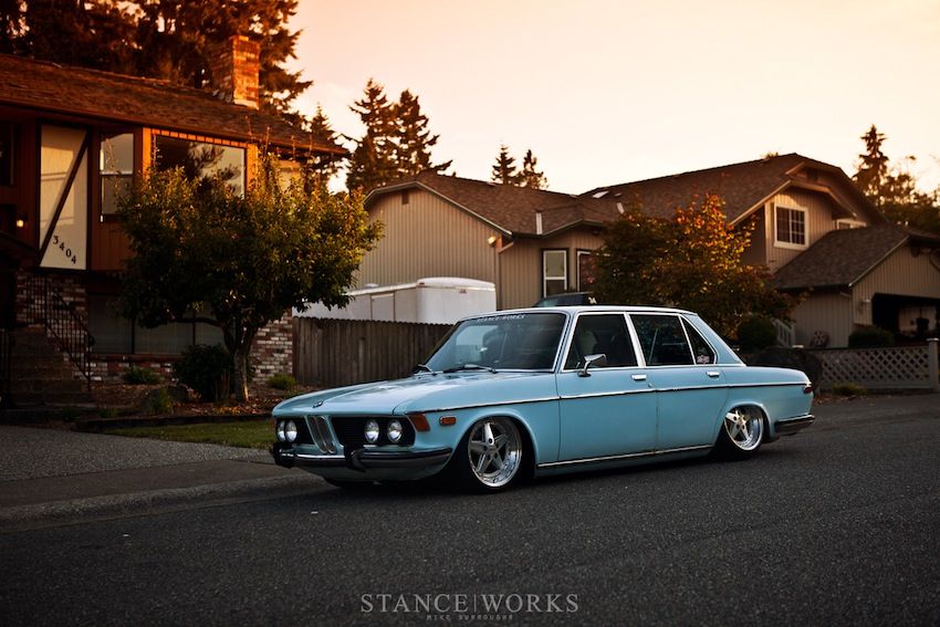

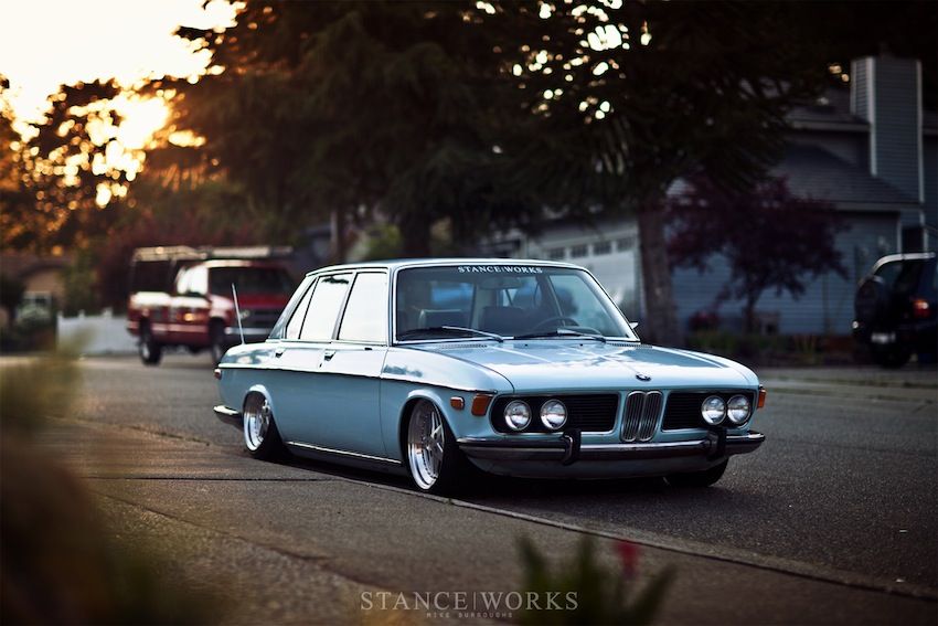

                          they're sweet heres a pic of my friends to give you some ideas:
                          ... yes its on air.
