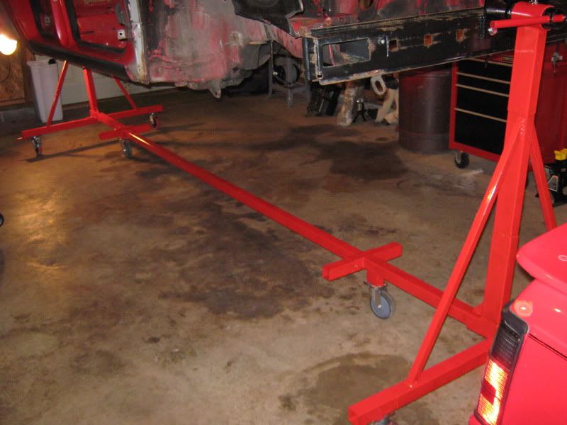

            Practical until a gust of wind comes up...mine cost $100 bucks in materials and can hold a lot of weight.
            A stripped chassis is not going to bend or tweak, a loaded car might feel some stress but this is a unibody style car, it was designed to support its own weight. By lifting at the bumper mounts you're only 18 moreinches out then where the car sits on its own suspension in either direction at most. Youre over engineering your idea. I am a bigger guy but i can lift this chassis as it sits right now, its not going to fold on itself.

                    The lowest part of my ceiling in my garage is 7'.....which is right over the middle of my car......easy up buttercup you'll be fine. Locking mechanism can be had by drilling holes in the pivot tubes and inserting a pin........did I do this?.....no, I live by the "KISS" rule, this chassis is light enough and the way I built it is when I want it locked on its side I kick in one of the a frame stands and let the bracket arm rest on it.
                    If I have time this weekend I'll write something up as well as maybe make a short video so you guys can get a good feel for how its put together, what I'd do different, how I mounted it and other things.
                    If there is something specific you'd want me to cover or would need an answer for let me know now and I'll cover it in the video as well.

                        This is mine:
                        It's losely based on one by xworks, I don't think he's on here but he has a drawing with materials etc in his thread - which is a full on M3 resto with every last bit of the car replaced/refurbed, maybe the best resto thread out there?
                        Mine cost me roughly 100euro in metal, the castors were about the same. If I was to do it again I'd "V" the legs and brace the vertical bit, also a castor under the vertical section would stop it bouncing and bracing would stop it moving back and forth. It worked perfectly and served it's purpose, the shell wasnt quite balanced but was easy to rotate, with the sunroof panel removed it was balanced perfectly!
                        I've only ever had a stripped chassis on it, wouldn't trust it with much more than that and subframes/suspension.

                          Here's mine, not an E30 but very similar. The bumper mounting points are more than sufficient and you don't have to worry about the chassis sagging or not being able to support it's own weight. At least not with a coupe/sedan.
                          Mine probably cost $300 all said and done. The castors were the most expensive part, I wanted nice ones that would roll on uneven or bumpy surfaces.
