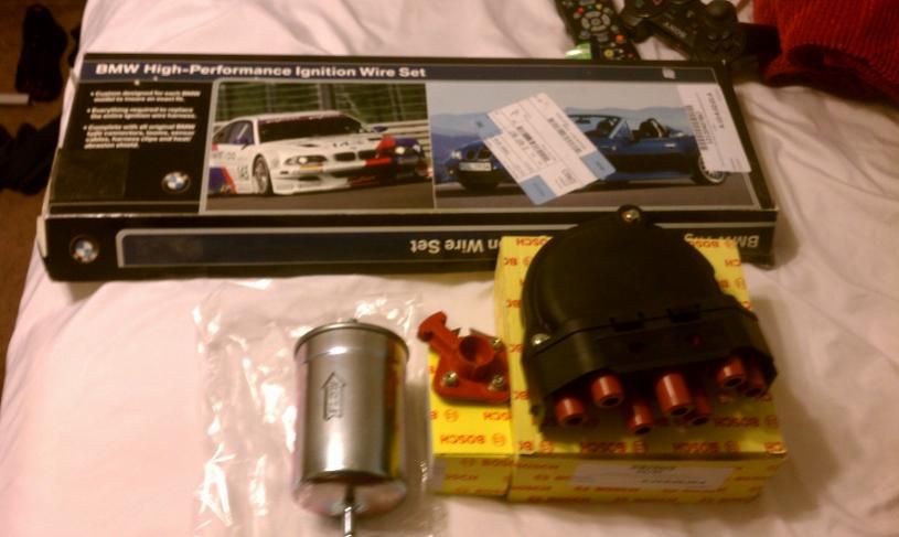

    jut a few goodies to be put on when the rain decides to piss of lol
    will post pics off what i take off

    GL with putting the rotor on, WHATEVER you do, DO NOT, DO NOTTTTT strip the rotor bolts, i came very close to it and its would have been a major PIA otherwise. The old one may be allen key, while your new ones are phillips heads?(IIRC)
    • e30construction
      • Jan 2013
      • 591
      nah the new ones are also allen key..and ill keep that in mind..if it doesnt rain today ill put everything on..hopefully all goes well..will post before and after pics as well as what the condition of the old ones was

        Nice to see somebody actually doing important maintenance. I'll bet those OEM wires weren't cheap!
          no they were not lol..timing belt and everything that goes with it is next as well as a new fanand fan clutch..and the motor/tranny mounts..but i gotta wait till a buddy of mine has time so i can come to his house since he has the big boy tools lol

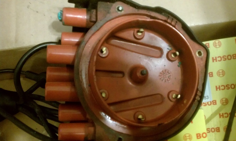

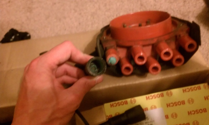

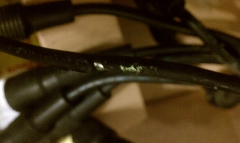

            i def found the culprit to the issues ive been having..
            She runs alot smoother and i def have alot more power thru the rpm range
