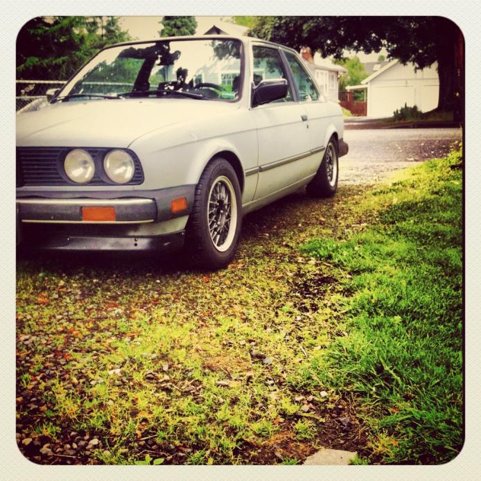

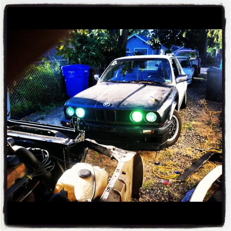

        You can use late model bumpers but it's a bit of work.
        For the front you need the valnce, bumper and brackets from a late model car. It all bolts up you just have to cut the tow hook.
        For the rear you need the bumper and brackets. You have to slot the holes in the car to mount it. Then trim the bumper down where it meets the wheel arch and cut a section out of the bumper trim, then use fiberglass to put it back together. The back is a pain.
        Here's mine I'm still working on the rear but the fronts done. This is an 85 325 with a 91 318is front end Click image for larger version
        Here's beforeClick image for larger version
