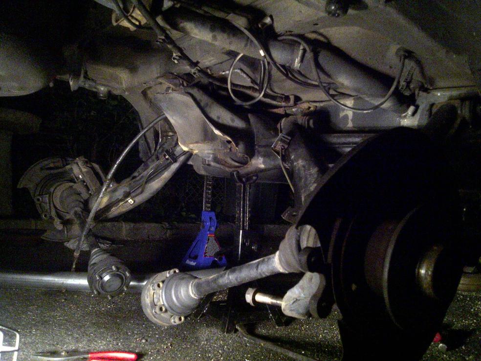

      I've already started, but like the e-brake cables won't budge at all, after having been basically drowned in PB for a week, one of the bolts for the support bracket on the driver's side has a broken and the bracket on the right has one of its bolt stripped. Plus, I have a few trim pieces and such that I can't find how to remove. Need some help with a few other things as well that are slowing me down tremendously.

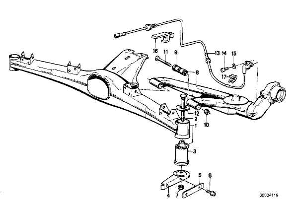

        Wasn't too bad when i did it. Used a jack to try and catch the subframe as I dropped it out of the car. Remove the rear shocks and springs, 2 bolts right above the diff and the nut labeled 7 and bracket 4. I think mine had been up there for a good 20 years so it took some cursing and two 36" pry bars but eventually gravity got the best of it.
        I just disassembled my rear brakes, pulled the disk and freed the ebrake cables that way when I did mine. Maybe someone knows a better way?

              ttrousdell: Yeah, I know what the steps are, but rust and poor maintenance by PO are making this quite difficult. Everything is seized.

                Rust really does make it impossible. Turns a two-day job to two week +. Lots of penetrating lubricant + torch are helpful.
                For the handbrake, I assume you're trying to undo the threaded portion above the subframe and behind the fuel tank? I did the same, lubricant for days, torches, etc. I gave up and cut them. I know it's stupid but I was moving the entire car trying to undo those damn threads and they weren't budging. I figured I could just buy a new cable but that isn't the case because the lines are stuck. Looks like I'll be living without a handbrake lol.
                As for the bracket on the drivers side, rusted solid? Might need some drilling and tapping.
