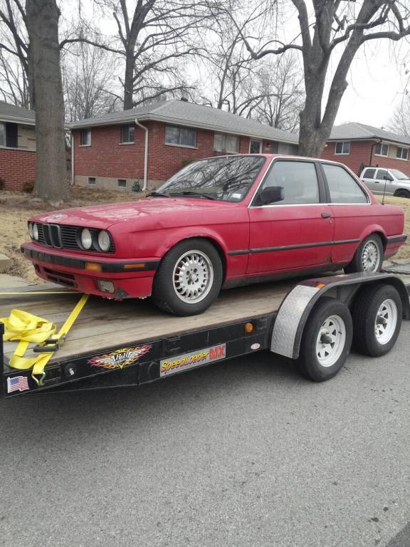

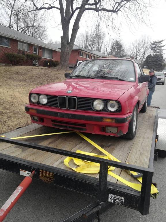

ID:	7164554Click image for larger version
          Sent from my LG-E980 using Tapatalk
          • flyboyx
            • 8371
            oy! she's gonna need some work. this one would be a parts car in my book. get it running first. just look for a good running engine in a junk yard and call it a day. you have a lot of rust to take care of. probably not a car worth dropping a lot of money into engine mods. if this is the car you are starting with, i assume your budget is limited. don't waste your resources on stupid shit.

                    Nope it is exactly what I was looking for. An e30 I wouldn't feel bad tearing apart. Aside from the rust under the door which we be removed and sealed over the car is in good shape. Sub frame looks good and the motor is in good shape other than the timing belt breaking. It was being daily driven up until last week. Again I am not looking for a bunch of power here and I'm just not interested in the motor swaps for this particular car. When I looked into building a street car it was going to be an S52. This is obviously a harsh crowd here haha
