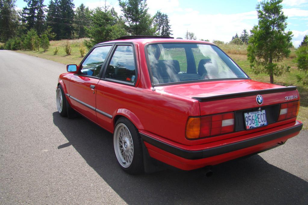

                Wow, a lot of diving board lovers in here. Fair enough, and thanks for the comments. Let's talk wheels then.
                Can I get close to something like this without the roll? I know the front is not possible on stock fenders. But i'm looking for that kind of drop and in the ballpark of that sort of fitment (though obviously less offset in the front).
                Thoughts on offset/size and springs?

                  There's a few things to consider with the red car you posted. If memory serves correct, that car is on adapters, so while the 16x8 style 5's are et20 or so, they are using at minimum an 18mm adapter, possibly 25mm, so the actual offset is probably somewhere in the et0-5mm range. For a mild drop, you can get by with H&R sport or race springs. The early model cars also can pull off the Ireland Engineering Stage 3 springs without the "reverse rake" issue. I'm guessing you're looking for a daily driver suspension, so Koni's or Bilstein sports are a good option. Otherwise there's Ground Control or TC Kline coilover kits if you want something a bit more agressive.
                  For the wheels, you may as well get some ESM 16x8 if not 16x9 (there have been issues with the bolt patterns and how they're drilled, so I'd do a bit of research on them first!). Tires will be 225/45/16 for the 8 inch wheels, and 16x9 wheels tend to use 215/40/16.
                  If you can swing it, keep the diving boards! With some polishing of the bumpers and repainting of the trim, the diving board look can look pretty tidy (just my two cents, but I'm partial to the front snowplow look ;D).

                    Thanks for the reply and the info Joey. I'm leaning towards ESM 002 16x8 ET20. So you think a 225/45/16 will fit up front without a roll? A good friend of mine is running 001s in that fitment with 205/45/16. I'll have to take a look at his car and see what kind of room is left. Though, it's a late model 'vert, so not exactly the same thing.
                      That setup will absolutely need the lip of the fenders rolled flat. I am running 16x8 et24 in the rear with 215/45 kuhmo xs on my early model, paired with ground control 440/650 springs. My car is sitting so that there is about 5mm of gap between the tire and the fender. The wheels are just about flush with the side of the car (et20 will bring you flush). In my experience you will rub your sidewall under acceleration, and bumps without a roll. Softer springs will make matters worse.
                      225/45/16 also has a larger circumference than stock. On a stock motor all you'll be doing is making that eta work just a bit more, and the result will be your car becoming slower than it already is.
                        Thanks for the data point Chris. This is exactly what I need to hear. Do you have any pics of your car (I didn't see any threads under your user name)?
                        So it looks like a 205/50/16 would be the size to run with stock fenders and 16x8 ET20. I have a friend who is running this setup on stock fenders on a late model 'vert, so it should definitely work. I had figured that the early rear could accept a larger tire and i'd go with a staggered setup. But it seems this isn't the case.
                        I'm not that concerned about the effective gearing change from a taller tire. The car is slow and will always be slow. If I want it to be faster, i'll throw a 24V in it. Thanks again for the info.
