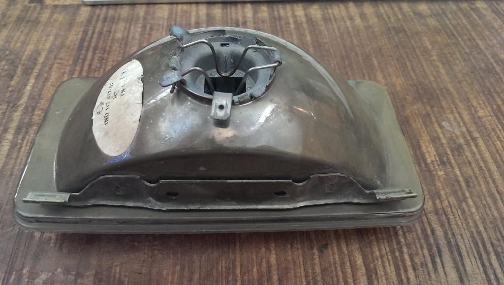

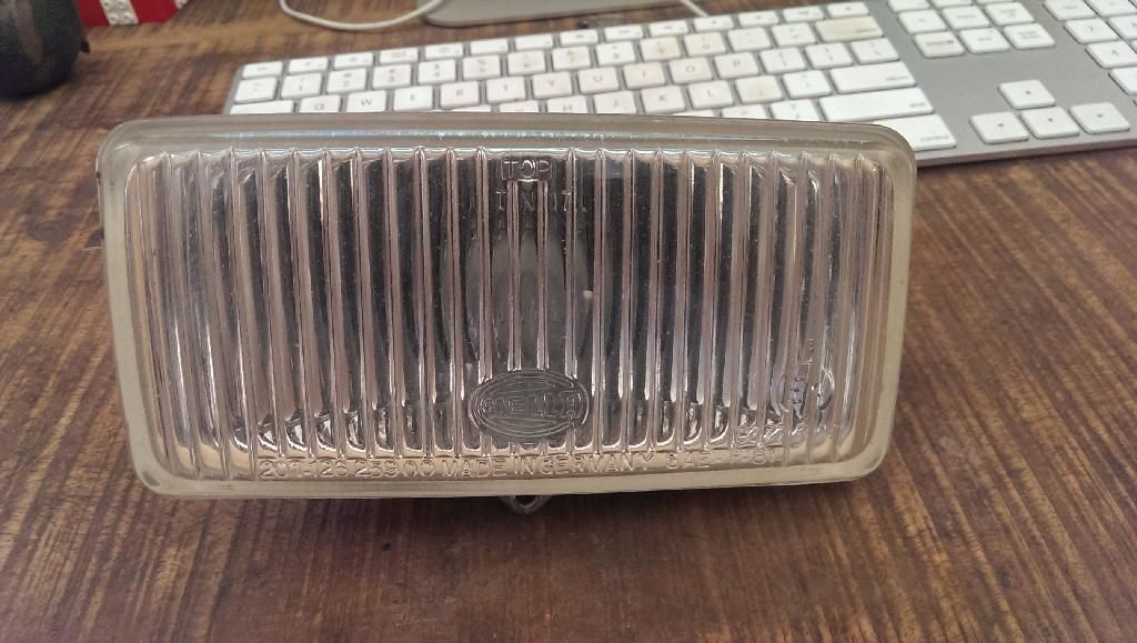

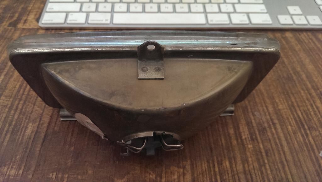

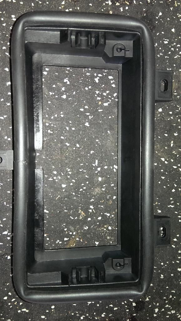

    So I need your all-knowing collective intellect to help me identify a set of fog lights. I've exhausted my googling abilities, so we'll see if you gents know. I'm trying to piece together an early euro valance, and picked up these fogs to fit in the dealer ordered brackets. However, they definitely don't seem to fit nor do they look quite right. They look closer to the fogs that mount in the earlier is "cow catcher" valance.
    Identifying marks on lens-
    Centered HELLA logo, bottom portion of lens
    201-126 259 00 MADE IN GERMANY SAE-F-81, bottom of lens under HELLA logo
    E1 encircled, above numbers 83 77 R 19
    On the back-
    HELLA paper sticker with # 1ND 117 477-01
    On to the pics-
    FRONT
    BOTTOM
    TOP/BACK
    Dealer ordered bracket

    Sure those are the wrong lamps. Looks like the DB sized fog lights

      I have a set of these in my 87is valance. I found them on an 84 bumper mounted. I drilled out the spot welds holding the brackets on and it was a perfect fit, same lens.
      These are NLA and should have some value.
        I've sold a pair of fogs with mounts for 50$. For early airdams and the sets than hang off the DB. The fogs for early airdams dont fit where the euro fogs go. Completely different lamp and housing

            Well heres the parts list on realoem. Where you'd be able to get it beats me. afaik they're NLA. Unless someone is hoarding NOS or has a used set.

              Early euro fogs are the same as m3. Lenses can be found new. Good luck getting your hands on the brackets.
