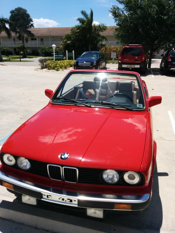

    Well, I've gone and done it. I bought a 325i '88 convertible.
    (Sorry for the lousy pic, I was in a hurry packing up a family of 4 for a return flight home.)
    It's in pretty good condition, no rust aside from the usual battery tray, all stock, well maintained... yadda yadda yadda.
    In three weeks time, I'm going to drive it from Florida to Milwaukee. It's had a PPI with compression test and everything checked out aside from a few issues. I've replaced / fixed the following: steering rack, some leaky transmission seals, timing belt, thermostat, transmission pan gasket, and I had the cooling system flushed, new tires, and windshield wipers.
    I drove it about 200 miles before parking it in my dad's garage until I return. It's seems strong and solid, pulls well and felt happy cruising at 85. I'm reasonably sure the car is in good mechanical condition.
    I think I'm ready to go.
