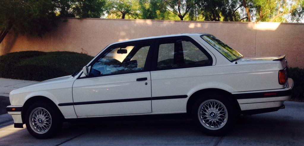

    I have a perfect E30 with the exception of residue on my windows no matter how well or how often I clean them. I'm hoping I'm not the only one with this issue. I can only describe it as a cloudy white film. If I wipe my finger across the inside of my windshield for example, the film smudges off. Anyone?
