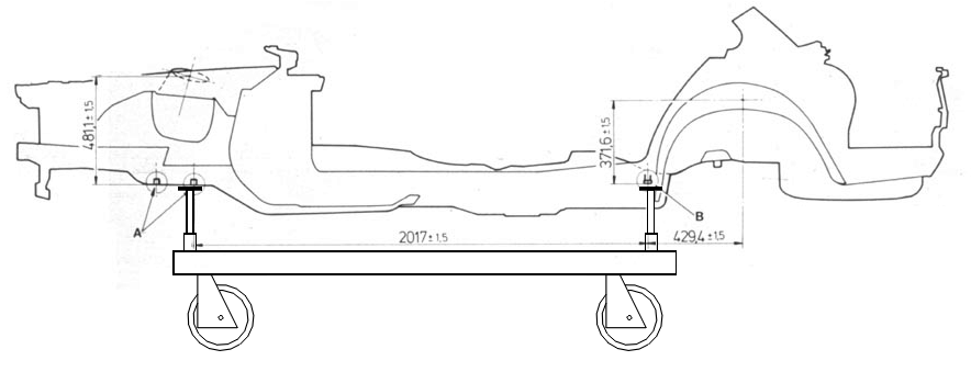

    Anyone build or use a rolling cradle/trolley to move an E30 shell without suspension? Calling for pics, drawings or plans.

      not after a rotisserie. Just something to keep the car mobile while the suspension is off. It's at a mate's workshop and either I have to keep it mobile or wait till other his projects are out of the way when there will be space.
      I could fabricate something like this out of RHS
