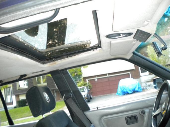

                          Just an FYI for anyone with a glass moon roof...
                          The epoxy used to bond the glass to the metal sliders will eventually dry out and lose it's hold. This happened to me - the bond on one of the sliders let go at speed. Picture one side of the glass flapping in the wind. Scared the crap out of me and my wallet. All I could picture was a $500 glass Frisbee flying through the air and shattering on the pavement.
                          Check this bond often. Any automotive glass shop will have the glass epoxy if you need to re-do this connection.

                            That is a super clean headliner. Is the car in the background yours too?
                            Edit: You have TWO '58 MGAs? Don't see that often.
                            • lgb240
                              • 204
                              Thanks ... touring headliners are all fabric; they don't have the plastic front section that holds the sunroof switch or crank handle, sun visors and diagnostic led board.
                              The black 318is in the back ground is my old winter beater; since replaced by an e46xi touring.
                              The blue tarp is covering my street MGA. It's was on jack stands at the time for an engine transplant (modified 1800 MGB). My second MGA is a project car ... needs a full restoration. I have a 3rd MGA - a vintage race car. It's a 1956; it won it's class and came in 23rd overall at Sebring in 1957.
                              I think I saw you / your team at Beaver Run this year... I wasn't racing but crewing for some friends (MGA, BMW 2002).
                              Cheers, LGB
