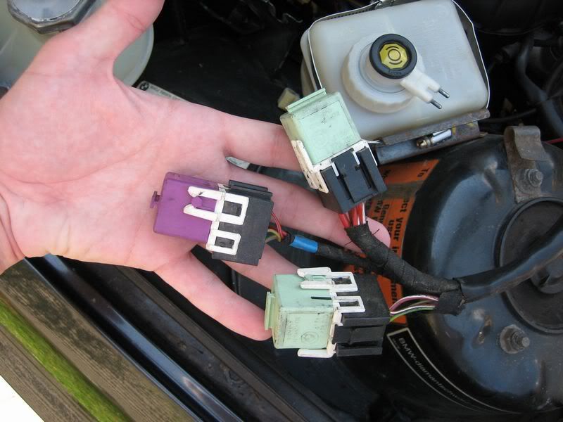

    Fuel pump relay
    Is one of these the fuel pump relay? If not where is it?
    I know one of them is the o2 heater relay. Could someone list what these 3 are for future reference?
    Thanks
    Thanks
    The purple one is probably the main relay. The 2 green ones are fuel pump and o2 heater.
    Check the bentley for the wire colours to see which is which. They both use identical relays.

      I only have a haynes for e36, it has yet to help me lol.
      Thanks though!

        The Main relay has 5 pins where as the other 2 should have 4, then the Fuel pump relay will have Red/White wires running to it.

          Is it just a normal 4 pin relay? Rat shack has bosch 4 pin relays.
