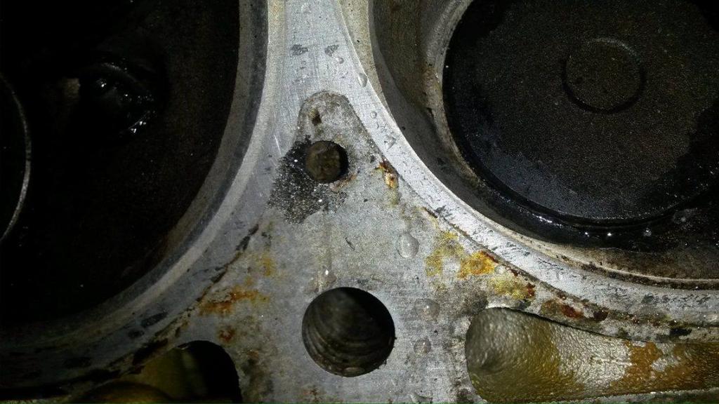

                  i pulled head again this afternoon. my friend gave me a head that he had and i am going to swap everything. it has a small blemish, will upload a pic soon to determine if it is detrimental or not
                  • soates4
                    • Oct 2015
                    • 33
                    this is it
                    • soates4
                      • Oct 2015
                      • 33
                      head is not warped. i checked it, id like to avoid the machine shop if possible
                      • Exodus_2pt0
                        • 5943
                        Clean it up, do you have a true straight edge? I'm talking thick piece of steel designed to check for warpage. Set it on, shine a light on the other side type deal.
                        If it's 100% sure to be true, clean and use.
                        Also get the timing on the head close, and the engine to TDC before install.

                          Also - make sure to use washers this time. They'll spread the load across the face of the landing.
                              Sounds like you're going to be doing the job 3 times.
                                Milling isn't a requirement, assuming you know how to properly ensure that the surface is true.
