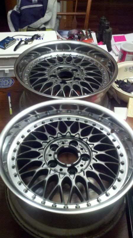

    What mine look like for reference. We may or may not have different standards, mine look good to me haha I'm a noob at polishing though XD. Definitely need to do another layer of polish, and the lips are a bit blemished cosmetically clearly, but can't do much about that

      I finished my wheels off with 3000 grit meguires paper for probably 2 hours each to make sure everything was gone. i hand polished with mothers billet aluminum and they came out spotless, mirrorlike, and with nearly no scratches.

        here they were after the first polish.
