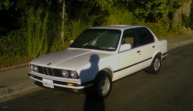

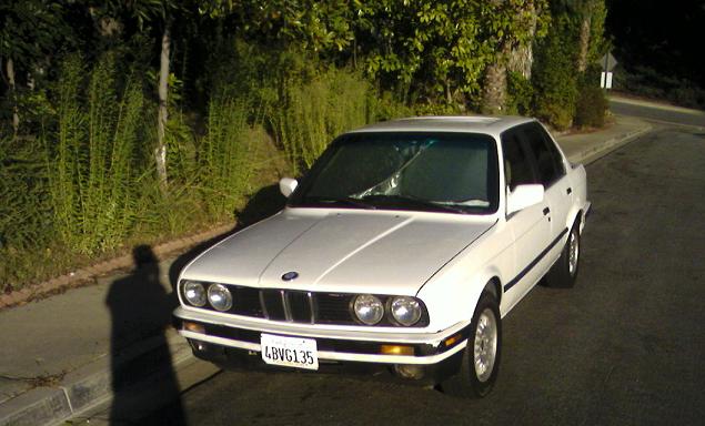

    Hey guys.. just picked up my first E30. 90' 325i.
    Anyways, I was able to get my foglights to work a couple times, turned off the car and when I tried to get them to come on again... nothing. My question is, does anyone know if the switch on the dash goes bad? The indicator on the dash wont even come on anymore. I dont have an ETM as of now and my meter is at work so I cant really check anything. Fuses "look" ok. If anyone has had anything similar i'd apreciate the input. Thanks in advance.
