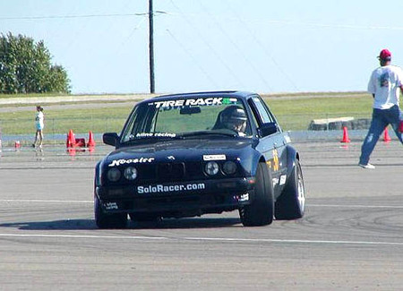

                          Thanks, Luke, for the info. It looks like I might be on the right track. I just got word that an 89 325is placed second in D Street Prepared at the Nationals in Topeka.
                          I wish I knew how he made those flares.
