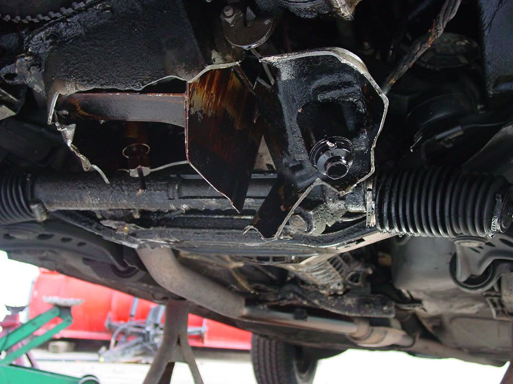

    ...that I've r3v'd my oil pan
    pump is toast too, just what i need is more bills...

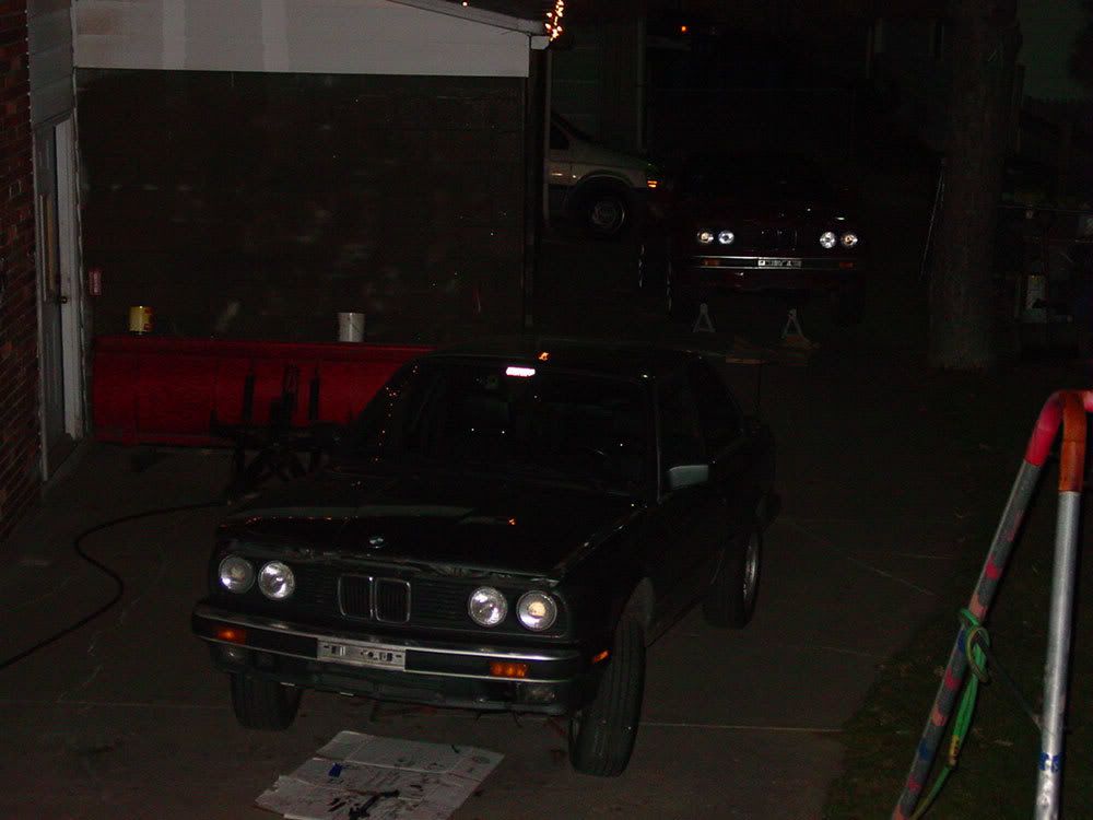

                  Well, managed to get both pans off before dinner...girlfriend meeting family for the first time...fun
                  a closeup of the damage, yes, that piece is hanging off the ground strap
                  don't they just look so cute together under the lights?
                  pan off the red car is usable, the pump may not be, its full of metal shavings...I'm debating taking it apart and cleaning it or just getting a new pump...findout how bad it really is in the morning
                  happy holidays, hope yours aren't filled with the kind of fun i'm having ;)

                            its up and running, for the moment atleast
                            the shaft that drives the pump snapped and left that little hex end way up in the block...got it out with a long needle and a (very)strong magnet
                            the pump on the red car was well within tolerances, pan was full of metal, but the pump was pretty clean, took it totally apart to be safe, and almost lost that little C clip on the pressure relief valve about 10times
                            someone had used sillycone instead of an oilpan gasket on the red car, all the **** that got inside the pan had found its way to the oil pickup screen, i'm surprised the thing had oil pressure at all, even with oil/water milkshake it still pumped
                            I don't mind sarcasm, actually I laughed at the comment, would buy the pan and pump, but I kind of need an engine to put them on, and who knows if an m20 will be going back in the red one ;)
                            I'm going to acquire some beefy stock with which to fabricate oil pan protection!
