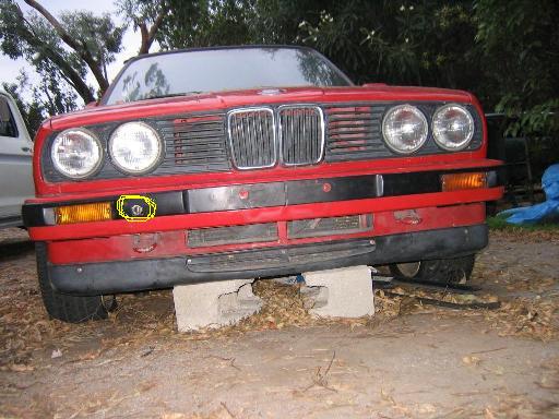

    What is this on the front bumper?
    I recently purchased a 90 325i. The front bumper filler was cracked so I bought one on ebay. The one I bought had this square cut out, mine was not cut. What is this for? I see something poking out of the bumper in this picture I found on this site.
    Looks like I might be doing some bondo work to get this filled back in before I paint and mount the piece I bought but I'm interested in knowing what it was for.
    Thanks in advance.

    It's for a screw in tow hook that is stored in the trunk.

      that's the tow hook threads. there's a small snap in piece of plastic that covers it when its not in use.
      Dan

        Would you patch the hole if U were me?
        To me it looks crappy. I'm sure there are other places to hook onto if needed. Thoughts/suggestions? What have others done.

          lol no, don't fill it in. Just go to the dealer or junkyard and grab the little plastic trim piece that goes there.

                If that piece just pops out, then I have it on my existing piece

                      There is a small 1" x 1"(?) plastic cover plate that will cover up that hole.
                      If you were in need of pulling the car onto a trailer if it suddenly broke down, you screw the tow hook into the bumper through that hole. Normally the tow hook is in the trunk, and not exposed like in Erik's photo. I think the plastic cover piece for that hole is less than $2 from the dealer.

                            Ok, I have that little cover installed in my car, it looks great and flush, just get the cover and it'll look great, also i have a towing hook through my front and rear aprons ????
                            well, if the germans put them there, you will need them some day. ;)
