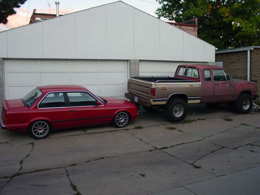

              '73 dodge ram FTW!
              I'd get a diesel for alot of towing tho, gas sucks. My dad has a 98 dodge cummins diesel. Not only can it tow my car, but while towing my car, can out drag my other car. :(

                Hey is a extended cab too :up:
