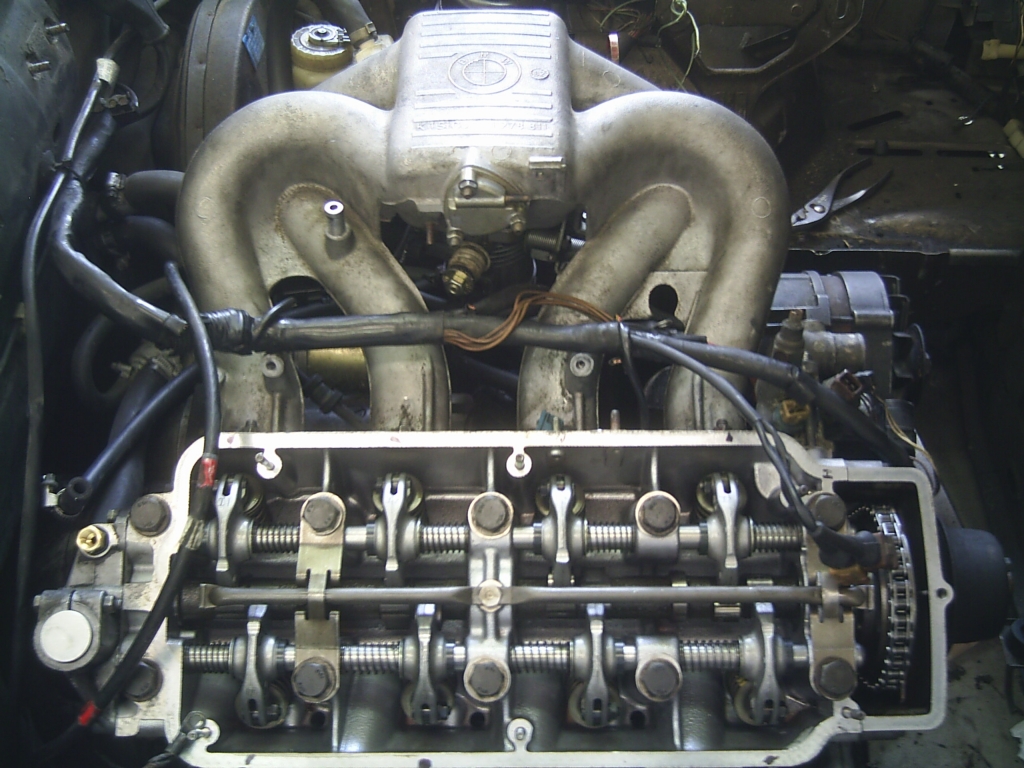

            Head Mods:
            Beadblasted chambers, valves, ports
            Heat tanked
            Milled .007"
            New Seals
            IE DUAL VALVE SPRINGS w/modded stock retainers and seats
            Schrick 292 CAM
            M10 FTW!!
            similar to mine!
            Head Mods:
            Milled .alot
            New Seals
            zomg's! SCHrick DUAL VALVE SPRINGS w/custom spring seats, and ti retainers
            Schrick 304 CAM

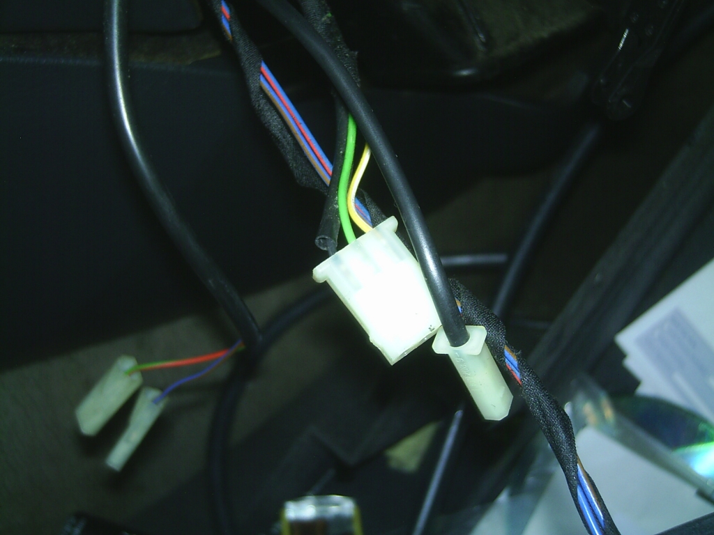

                  is that where the harness connects to the ecu?? do you have a diagram i can look at bc that would be awesome if i can use the stock tach?
                  i think i know what you are talking about
                  • SoopaGhetto
                    • 573
                    Is it one of these...im thinking its the one with three
                    • Mr Deagle
                      • Nov 2006
                      • 1121
                      yes, the black wire on the three pin connector, it needs to get a square wave rpm signal (dont hook it to the coil) you can probably run it of of the megasquirt

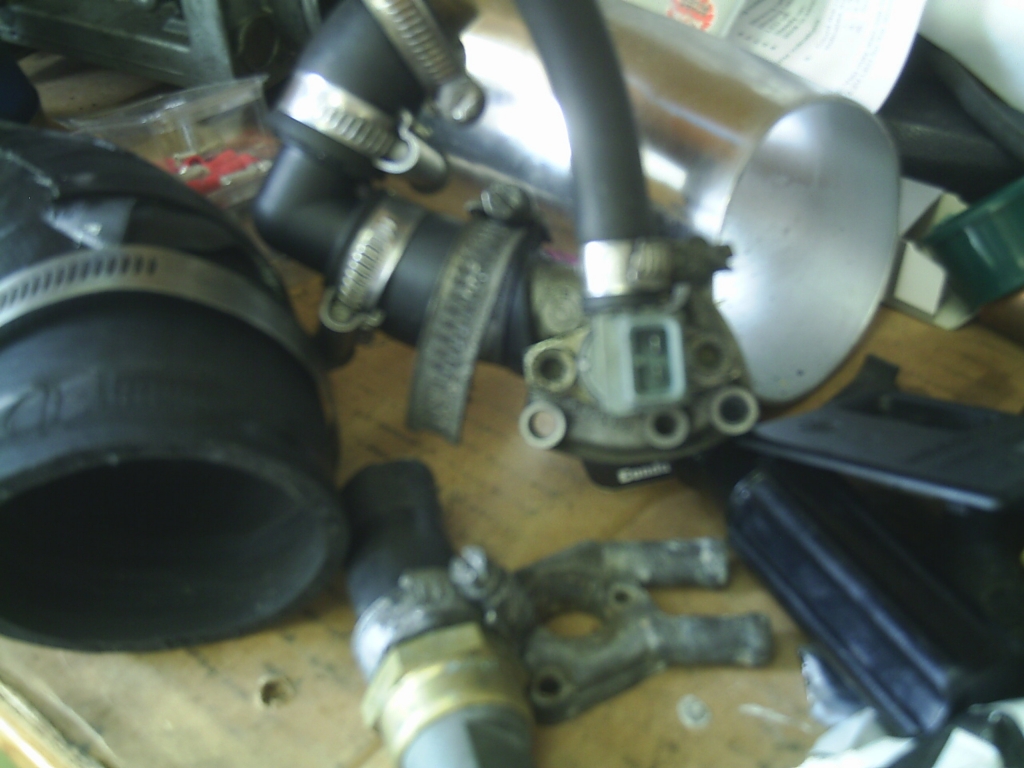

                            so thats two things im using from a 325i: TB, and that vacuum thingy
                            the dizzy plug is from www.02again.com

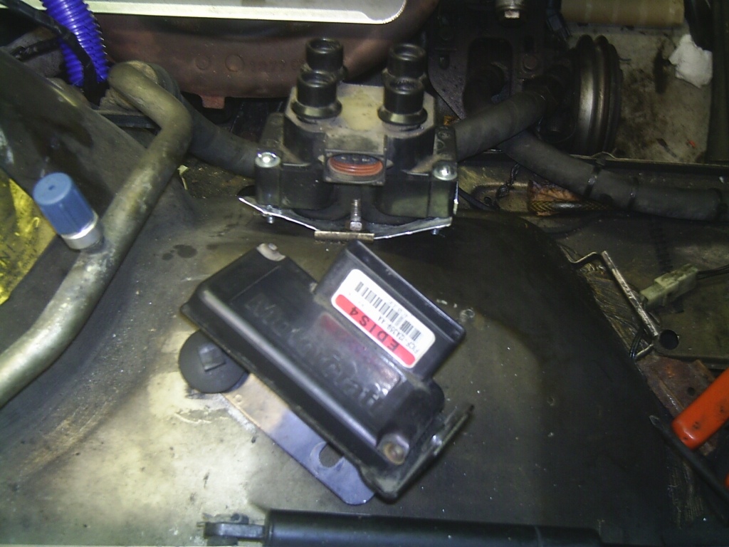

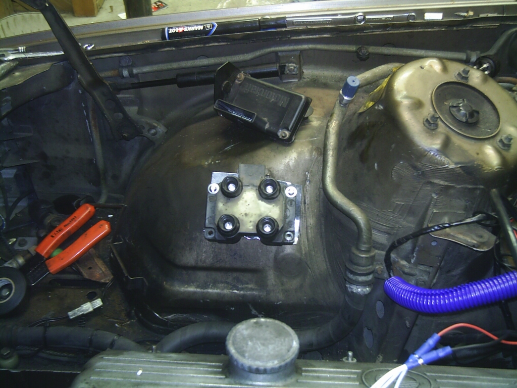

                              You see the edis unit will be using. I made a bracket to hold it in place. i think its a nice location for it

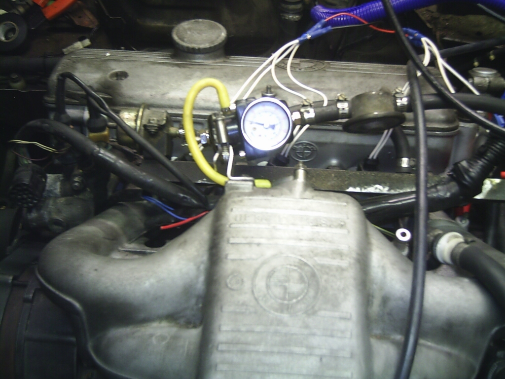

                              Also you see the AFPR, i also made a bracket for it; its mounted to the manifold.

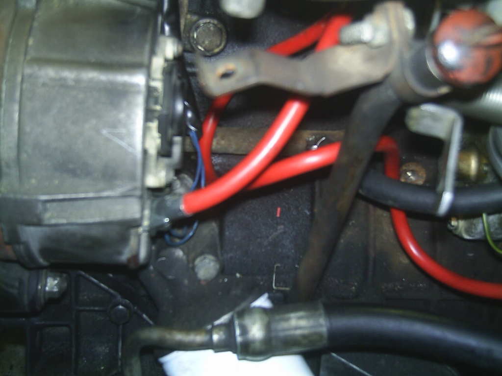

                              I ran into some problems with stock wiring...the alternator wire was all frayed to hell. went to advance and got all new ones;
                              Unfortunately i will not be getting the 24lb injectors as i thought :( my friend lost em...
                              I have mounted the MS unit using the stock ecu mounting bracket. I have also begun to wire the megasquirt, not to bad. So far ive wired up the injectors but hella lot more to go. glad they have lots of diagrams and shit.
