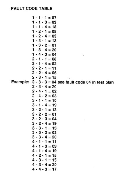

              I'm the proud owner of a '92 325ic triple white. It's a USA spec car with a 525 Motronic ECU and an SRS computer. Since purchase, the SRS warning light on the overhead check panel has indicated faults. When the car is started, the SRS light flashes for about 4 min, then glows steady. After trying a recommended local import shop and the dealer and getting "gee, we don't know", I found a faq from Jeff Cocking on the big coupe groupe (http://normgrills.net/bcg/Listing_by_Topic.html) indicating that shorting diagnostic plug sockets 1 and 6 and turning the ignition to 1st position would get the check panel lamp to spool out fault codes.
              Well the SRS computer/motronic indicated 3 faults: 1,4,3,1; 3,2,3,1; 1,1,4,1. The first three digits designate x,y,z numbers and the last is d: 1=brief defect (short interuption of plug contact), 2=permanent defect. Luckily all mine appear temporary faults. The x,y,z codes indicates what to check. I can use the x and y numbers to get started. The problem is that the z position is indicated to only be a 1 or 2 in the faq and my system is presenting 3s and a 4! Does anyone have a defect code table for this setup that discusses z numbers >2?

              See the fault code pdf from roadstergal in Doucments folder or at link below:
              r'gal reply:
              Well,you could start with the fauts that the x and y numbers give and work with those. That FAQ didn't really show any difference in the diagnosis with the z numbers.
              Or you could suck it up and get the tool.
              91318is reply:
              Unfortunately without the tool you are probably not going to figure it out. If there is a bad sensor or something you can not fix it by resetting it. I had a sensor ring in the steering column go bad a little over a year ago and I think it was around $300 to fix it.

              Thanks for the pdf. I hadn't come across that one. I'll assume I've got the SRS2 unless someone knows how to determine that precisely. I'm looking at page 19 trying to determine if I may be able to reset the system by configuring two jumpers and a ground strap from the diagnostic connector to the SRS harness.
              A couple of issues with this document though: First, the diagram of the diagnostic connector at the bottom of page 19 is a mirror image along the pin 1-to-pin 7 axis i.e. pin 6 (the SRS connector) is to the firewall and passenger's side of the car not the driver's side of the car as indicated.
              Second, how does one convert the x,y,z,d code to a single digit code.
