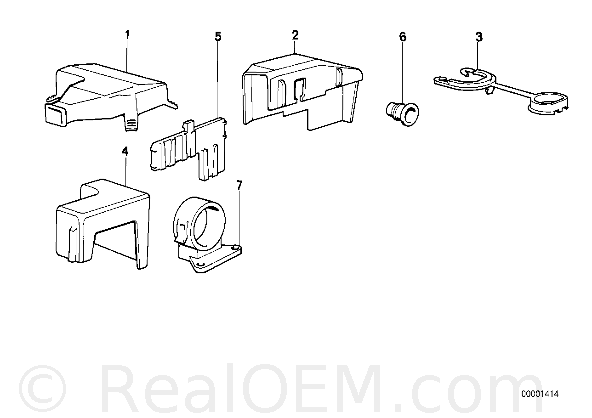

help find a part number?? please?
  • sefb222
    • Apr 2007
    • 1206
    http://www.realoem.com/bmw/diagrams/e/y/6.png
    number 7 in that diagram...
    edit.. dammit.. realoem wont allow the link.

      here.. this should work
      need item #7

        On the same page as that diagram there should be a list at the bottom of the prices and the part numbers, isn't it there?
        • sefb222
          • Apr 2007
          • 1206
          yeah, but that particular part isnt listed.
          it has 1-6
          #7 isnt listed.. it says (something like) "if part is pictured but not listed, it is for a different year"
          Originally posted by Holland
          There should be a restraining order to keep kids 100 feet from that car at all times. Plus execution on the sight to anyone who places a shopping cart within 200 feet of the thing.
          • AlpineIS
            • 161
            That means the part pictured does not apply to the vehicle selected. Can you describe the part?
            • M42Technik
              • 9781
              Try a different model, maybe it came on the base model or "e" models. You have to search with other cars to get to it.

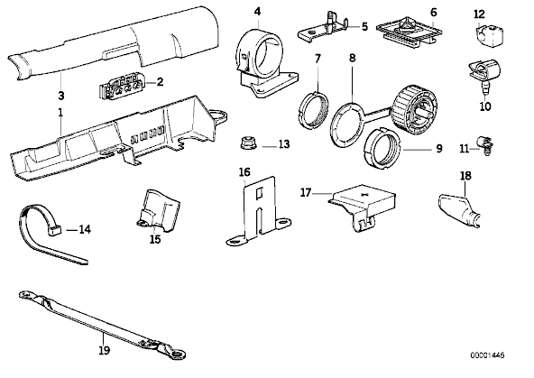

                  ah, the diagnostic connector holder for a 318is?
                  • FredK
                    • 14763
                    #4 in the diagram, for a 91 318is:
                    Part number 12 52 1 710 729
