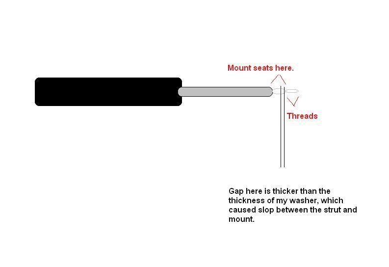

                    I destroyed what was left of the strut....
                    I have been working with air tools, they are nice as hell!
                    Anyways, I was rethreading the strut with another nut, worked great for a while then I stripped the allen socket at the top.
                    Then I took a pipe wrench to the spot that the strut mount goes on, not the place it tells you not to put a pipe wrench on lol. But the fuckin nut won't go down enough and I can't keep a grip on it with the pipe wrench.
                    Yes the washer was on, but the problem is the washer isn't think enough or something, worked just fine on the other side, but this side its waaay off. I need like 2 or 3 washers to fill the gap.
                    I lent my camera so I can't get pics, but heres an AWESOME paint drawing I made.
                    Would it be ok if I were to undo the nut on top of the strut on the other side of my car to take a look at how that one looks? I am saying without taking the actual assembly out, I would guess that the weight of the car would hold the spring down to keep everything in place until I put the nut back.
                    Edit:
                    Yes the bottom washer was in there too.

                        Isn't there another washer below the mount?
                          Yeah I thought of that like 2 seconds ago lol, I edited my post. Yes that one was on there too.

                            There are two washers underneath the strut mount, right? A fat thrust washer and another thinner one that cups the bearings in the strut mount.
                              I only had one when I took it apart, just a regular big ass washer.
