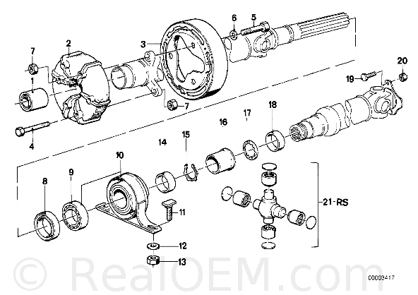

    Originally posted by psloan
    so WTF is a harmonic balancer? I just heard someone say it could cause this problem - and in other posts i've heard people say shit like "if you still have one throw it away"
    so, what does it do and why do I need it?
    "regularly check on your harmonic balancer, or vibration damper, to have a grip as to when you must change it. The BMW harmonic balancer is a product that attaches to the outside of an engine to control harmonic vibration inside (to the front of the crankshaft that is causing all the trouble). Moreover, this product is designed to prolong engine life by reducing wear on the main bearings and main journals and preventing crankshaft failure."
    "Its basic function is to lessen the torsional vibration which is produced when the cylinders fire and the power gets transmitted through the crankshaft, which then takes the brunt of this power moving and causing twisting motion and then snaps back to produce vibration. "
    Part # 1 ($358!!!!??? - http://www.pelicanparts.com/cgi-bin/...FILTER_GADG=ON)
          I believe this is wrong.. That's at the font of the engine, you want the one near the trans, part # 3:
          Vibration Dampener P/N 23131222514 $289.04
          which I think was superseded by
          Torsional Vibration Absorber P/N 26111434254 $116.62

            ALSO, About the Harmonic balancer.....
            Would these just go bad? i mean they are a solid plate of metal.. its not like its a waterpump or something...
            And even if mine were bad, would the vibration from it, make its way all the way through the Motor, clutch, Tranny, and to the driveshaft?
            it seems like id have i wrecked tranny before i had a rubber guibo go to shreds..

              It's safe to remove it. Give it a shot and see if anything changes. Just make sure you remove the correct one (see my post before this).

                Oh,, SPEAKING OF WHICH, i did have the Rear Vibration damper removed, it originally was there, but was removed almost 2 years ago when i put in the z4 shifter..
                Should i put it back on?
                (Front is HArmonic BAlancer, Rear is Vibration damper.. just so everyones straight on that)
                i still dont see the front hb going bad on an engine...

                    I DID NOT MEAN THE "HARMONIC BALANCER" ON THE DRIVESHAFT. I MENT THE ONE AT THE FRONT OF THE ENGINE.
                    These balancers are rubber encased i metal, and yes they DO go bad. I have seen these kill multiple driveshafts/associated parts by sending vibration through the driveline.

                        My guess is that they did not get the drive shaft angles within spec. You need to get it to damn near 0.0 in every direction. If you replaced engine/trans mounts, the trans is probably sitting higher than it was before, and the engine needs to be shimmed up in most cases.
                        Also I think there may be a bunch of junky guibo/csb out there, I bought some new ones and ate them, which also killed my driveshaft. I nabbed a complete drive shaft off a parts car, stuck it in and no problems.

                            The harmonic balancer is an internal metal part, and an external metal part with rubber in between, after a while, the rubber starts failing and the part stops counteracting harmonic vibration.
                            harmonic vibration: when the crankshaft is hit by the connecting rod on the power stroke, it twists a bit, it gets hit six times by the rods, ar some rpms, the twist/untwist cycle can start building up until some part in the drive system fails.
