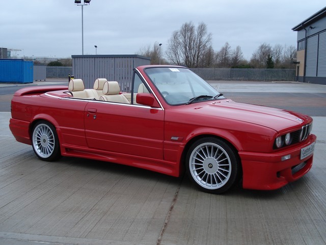

    I just sold my e30 M3 and now I am looking for a 92 325i convertible. I have seen a couple of conv. with head rest on the rear seats. My question is: Did they make any specific 325ic with headrest or is this a kit sold for these cars.?. I like the way they look.. I found this pic looking around and that convertible looks good. Not mine !! but I wish to be able to get it as close as that one...

    That is a nice lookin vert. Those headrests come as a kit as an option for BMW. They come with the brackets, headrests and little grommets, but All BMW rear seats are equipped to handle the rear seat headrest brackets.

            Yes, they are 1 size fits all.
            It's a very direct bolt on actually, just need to make holes in the upper leather of the seats for the brackets to go through. But you will eventually fill those holes with the grommets that normally come on the headrest assemblies of the front seats of E30's.
            If you look at my signature, you may be able to see the rear headrests in my car. It's the same for convertibles and very easy to install.
